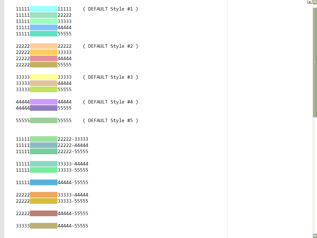

                  Hello, @alberto-bongiorni, @alan-kilborn and All,
                  Thanks again, Alan for this new script ! After some testing ,I preferred to use the regex mode. So I simply changed the line :
                              editor.search(inp, lambda m: matches.append(m.span(0)))
                  by the line
                              editor.research(inp, lambda m: matches.append(m.span(0)))
                  This modification provides two advantages :
                  • Firstly, we can simulate the Match whole word only and Match case options of the Find/Replace/Find in Files/Mark dialogs. For instance :
                    • Program will mark this string, with this exact case ( Default case )
                    • (?i)Program will mark this string, wahtever its case
                    • \bProgram\b will mark this word, with this exact case
                    • (?i)\bProgram\b will mark this word, whatever its case
                  • Secondly, it allows us to mark areas of differents lengths ! Test, against the well-known license.txt file, the two regexes below :
                    • b.*q
                    • (?s)b.*q
                  Nice, as this kind of marking is impossible with the Search > Mark All >.... native N++ options ;-))

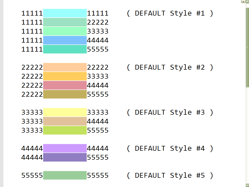

                  One more tip :
                  If you use a same expression for two or more styles, you can mark these expressions with the blend of all the styles involved ! For instance, the picture, below, shows the default style colors and the blend of two styles :
                  P.S. :
                  In the picture below, I added the combinations with 3 styles !
