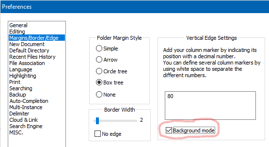

        Alan Kilborn @rd4gh
        @rd4gh said:
        I’ve been “suffering” without this for some time, but finally thought I’d ask if it could be restored as an option.
        lines that I want to be only 80 characters
        So here’s a method that requires nothing special – so I won’t call it a workaround – except for a change to a Notepad++ setting:
        Tick the Background mode box:
        After doing that, you’ll notice that Ctrl+i again works to split lines at your set column value; 80 in my screenshot.
        You may dislike the coloring used for the text background at column 80+, however it is a simple matter to adjust the coloring to a really light grey (assumes default white text background color/theme selected) so that the intrusion is minimal.
        End the “suffering”. :-)
          Hello, @rd4gh, @alan-kilborn and All,
          You do not need, at all, to stay with the Background mode set !!
          The best method for using the Ctrl + I functionality and splitting text at column N, is :
          • Run Preferences... > Margins/Border/Edge > Vertical Edge Settings
          • Wipe out all the existing column markers, if any
          • Type in the column marker N, ONLY ( generally the 80 value )
          • Tick the Background mode option
          • Immediately un-tick the Background mode option ( Important )
          • Re-enter all your previous column markers
          • Click on the Close button
          • Even though you can see all your column markers, again, Notepad++ remembers that the position to split text, with the Ctrl + I option, is column N
          • This behavior is kept, even if you use the Ctrl + I option on new opened files, on closed and re-opened files and after switching tabs !
          • The only way to reset this splitting behavior, on column N, is to close the current N++ session and restart N++ ;-))

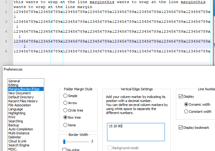

                      • dinkumoilD
                        dinkumoil @Alan Kilborn
                        Yes, I have seen this effect, too. It seems like character spacing is slightly smaller when DirectWrite rendering is activated. I tested some minutes ago with Npp v7.9.1 and saw that with DirectWrite the Scintilla window showed 85 characters and with standard rendering it showed 83 characters. In pixels the difference was 17 px.
                        Here are screen shots from my test, captured with a screen magnifier:
                        Unfortunately this issue causes the Horizontal Ruler plugin to draw an inaccurate ruler - Scintilla’s edge line is drawn at the correct position (after column 80) but the plugin’s ruler shows column number 88 at this postion:
