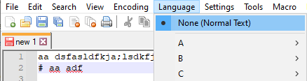

    • Carlos Zhang 0C
      Carlos Zhang 0 @Carlos Zhang 0

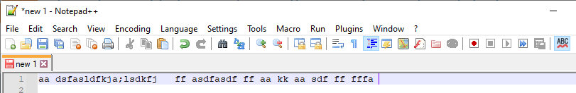

      I just found it works only if it’s a comment line.
        Alan Kilborn @Carlos Zhang 0
        @Carlos-Zhang-0
        …and you must have set a “Language” on your “new 1” tab without reporting that. The fact that you just had gibberish data in the tab also didn’t help (I get that you were just trying to test the speller). But, if it had been real language data (be it php, python, whatever), it would have been easier for someone here to help solve.

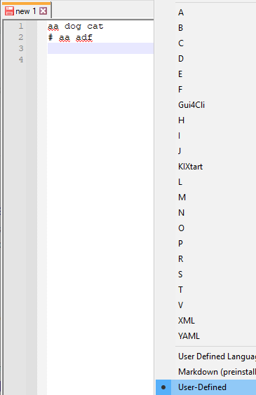

              • Carlos Zhang 0C
                @Carlos-Zhang-0
                I just found it works fine only if I change language to user-defined.
                Not sure why it doesn’t work for normal text.

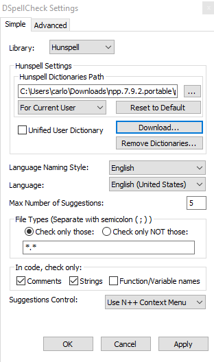

                  Have you noticed these settings which you showed?
                  Especially where it says “in code”:
                  Imgur
                  But still, curious why it thinks “normal text” is “code”.

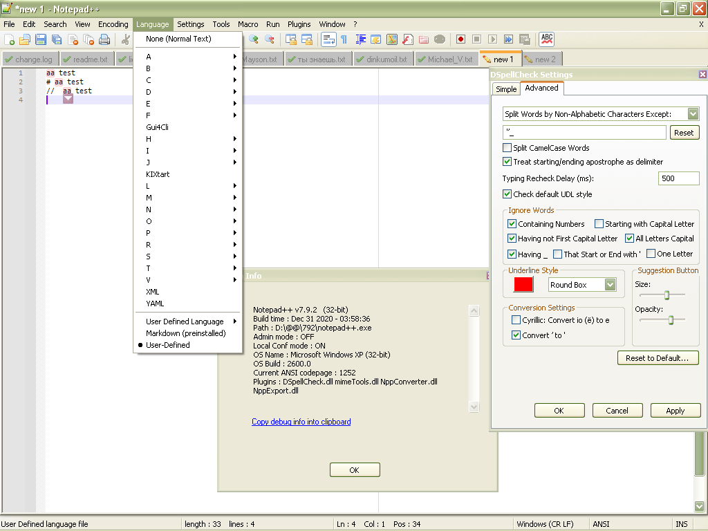

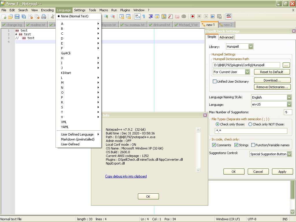

                      Hello, @carlos-zhang-0, @alan-kilborn, @peterjones,
                      As for me, it works nice, with N++ v7.9.2
                      • Whatever the language used is Normal Text or User-Defined
                      • Whatever the file encoding ( ANSI, UTF-8[-BOM], UCS-2 [BE|LE] BOM )
                      • Whatever text is considered as comments or not, when language is Normal Text or User-Defined
                      • When text is in comments or strings when language is a specific language, as C++ or Python
                      Note that I’m using the DSpellCheck v1.4.15.0 version which is the last version working with my OS ( Windows XP SP3 ). So, the behaviour that you described could depend on the newer versions of the DSpellCheck plugin !
                      Carlos Zhang 0C 1 Reply Last reply Reply Quote 1

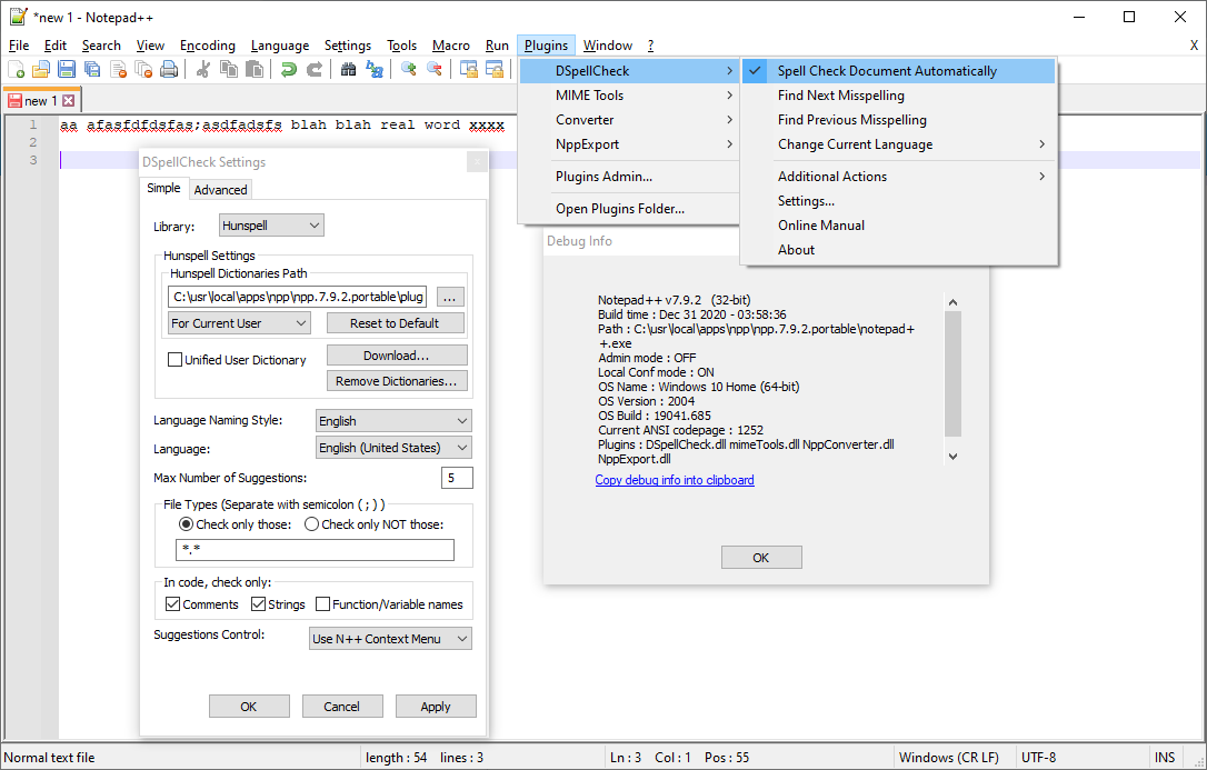

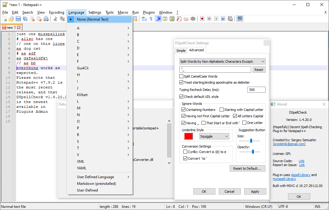

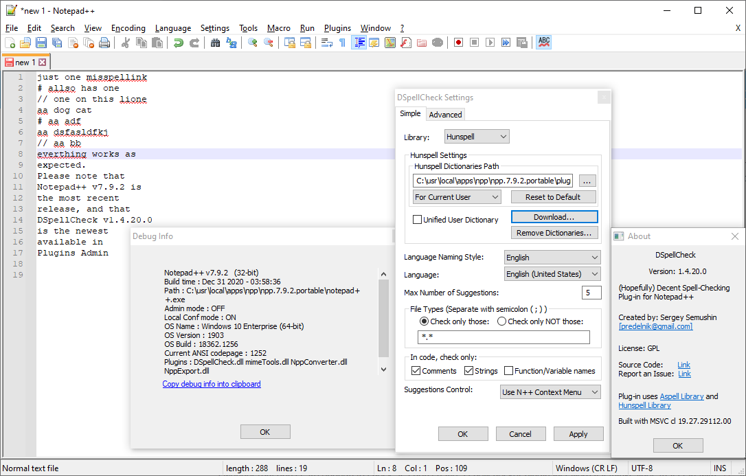

                          PeterJones @Carlos Zhang 0
                          @Carlos-Zhang-0 ,
                          Once again, it works for me, as I showed above.
                          In case you were curious, it’s with DSpellCheck v1.4.20.0, which is the newest available from Plugins Admin interface. So here’s a new screenshot showing some of your exact test cases working, along with other test cases from me.
                          And a second screenshot with my (default) advanced settings, plus the Language menu pulled down to doubly confirm (along with the status bar showing “Normal Text File” as it did in my earlier screenshot). As you can see, DSpellCheck works just fine with Normal Text files, and doesn’t just check spelling on “comment” lines.
                          Everything works for me, as expected, with the most recent Notepad++ and most recent DSpellCheck from Plugins Admin.

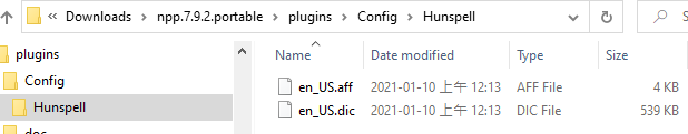

                              Not sure if you’re still having issues, but I ran into the same thing today. The resolution was to go into the DSSpellCheck settings and download the dictionary (English - US, for me). After that, spell check worked again.
