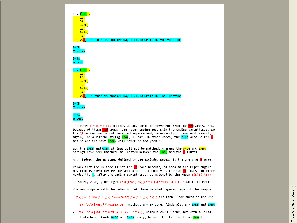

Hi, @alan-kilborn,
I thought it was better to write this post with Word and provide a screenshot, in order to see colored zones and some writing styles ;-))
The sample text used is :
x = foo(0, 12, 34, 0xDE, 12, 0xBA, 34, 27); // this is another way I could write my foo function 0xDE This is 0xBA a test x = foo(0, 12, 34, 0xDE, 12, 0xBA, 34, 27); // this is another way I could write my foo function 0xDE This is 0xBA a test
Alan, as it could be difficult to rewrite all the regexes for tests, here they are, in their order of appearance :
(?s)(?!\);). -
(?s)(foo\(|\G)((?!\);).)*?\K0x(BA|DE): Your regex -
(?s)(foo\(|\G)((?!\);).)*?\K0x(BA|DE)(?=((?!\);).)*?\);) -
(?s)(foo\(|\G).*?\K0x(BA|DE) -
(?s)(foo\(|\G).*?\K0x(BA|DE)(?=.*?\);)
Oh, I just saw the caret of my Word document, located inside the first
(?s)(?!\);).regex ! Don’t pay any attention ;-)) -
