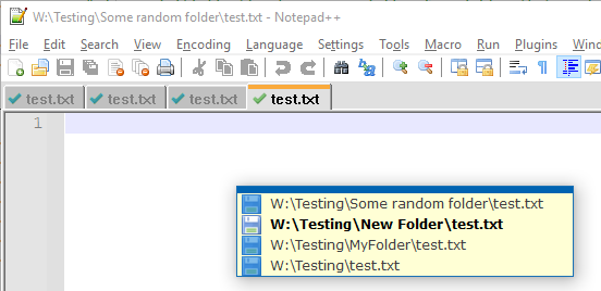

            Have you tried Ctrl+Tab document switching?
            Here’s what that could look like for this situation:
            If you have a lot of open tabs it can get annoying to “keyboard” through them to choose one. But, while the yellowish box is open, a mouse click on the file you want ends the box and takes you to the clicked-upon file.
