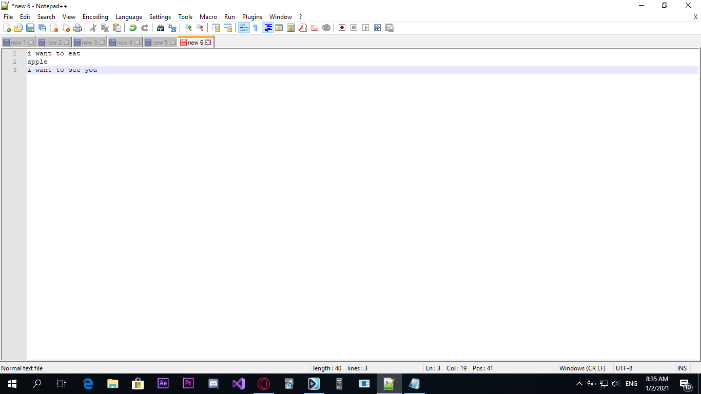

      if i have 3 lines and i want to merge the line which less than 10 word to the line above how can i do it ?

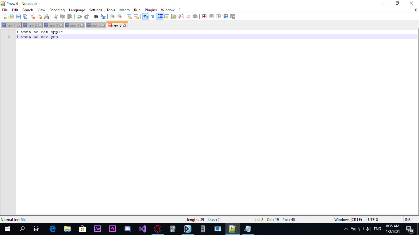

      and here how i want it to be
        I think you need more specification, as all lines shown have less than 10 words…

          @Alan-Kilborn ops sorry,hmm i mean less than the number i want =.=

              If I correctly interpreted the question —chars instead of words—, the following regex will help you:
              Search: \R^(.{1,9})$
              Replace: \x20$1
              Put the caret at the very beginning of the document, select just the Regular Expressions mode and click on Replace All.
              Have fun!

                  @astrosofista That’s exactly what im talking about,Thank u so much,appreciate that !!!
