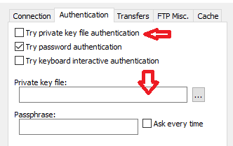

          Sometimes, due to the OpenSSL library used by NppFTP plugin, the encryptions/etc that NppFTP knows about is different from the encryptions/etc that your server is willing to use. I have that problem with at least one server.
          However, based on the error messages, it appears your host doesn’t want password authentication. My guess is that in FileZilla, you have that host set to use an SSH key to log in, rather than a password, but that you aren’t trying SSH key with NppFTP. You might have to enable the private key checkbox and fill in the private key file location for the IONOS profile:
          (I think at one point, I also had NppFTP working with pageant or a pageant-equivalent SSH key agent, but I don’t currently have an example of that working available right now, so I don’t remember how it all worked together – but I think it had the checkbox enable but no keyfile in the text box in those settings.)
          If that doesn’t help you, I’m not sure how much more we’ll be able to help you here.

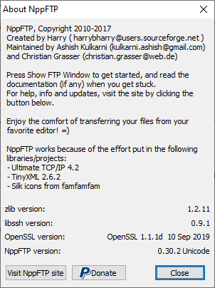

          If you look on your Plugins > NppFTP > About,
          … you will see the Visit NppFTP site which then links to the NppFTP issue tracker, which is where you would go for help specifically on NppFTP. I would recommend, since you can successfully connect to that site using FileZilla, but not with NppFTP, that you share you NppFTP profile settings and the FileZilla profile settings in that issue you create over there. (If you do create an issue with NppFTP issue tracker, it’s generally considered polite to paste a link to the issue you create in this thread, so that anyone who reads your request here can follow it to its conclusion over there.)
