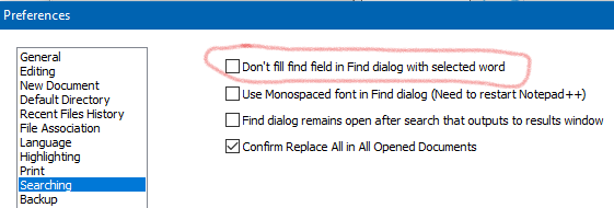

                    @carypt said in Invisible spaces:
                    your ctrl+f-idea didnt work out for my system
                    For that to work you’d have to have this setting set the way it is shown here:
                    caryptC 1 Reply Last reply Reply Quote 1
