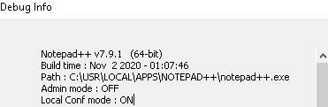

        It depends.
        1. Normal installation: %AppData%\Notepad++\shortcuts.xml – if you paste that path into Windows explorer, it will go to the right directory. 🛈
        2. Cloud: if you have Settings > Preferences > Cloud enabled, the shortcuts.xml will go in whatever folder you have defined in that dialog
        3. Portable / “Local Config Mode”: if you have a portable Notepad++ (unzipped a .zip/.7z, rather than installed Notepad++), it will be in the same folder as the notepad++.exe executable.
        If you look at your ? menu’s Debug Info, you can see whether it says Local Conf mode: ON or OFF. . For example, mine shows ON because I use portable:
        • official config file docs: https://npp-user-manual.org/docs/config-files/

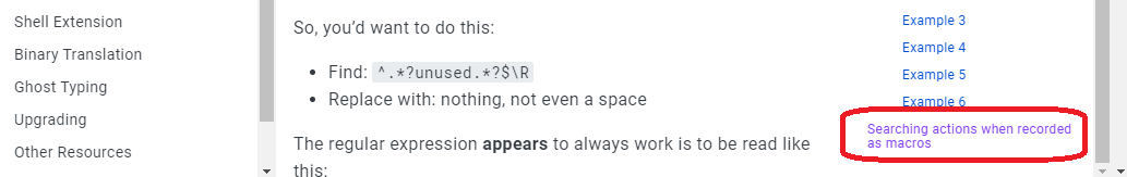

                  Also, the section at the very bottom of THIS PAGE in the documentation (entitled “Searching actions when recorded as macros”) will help you understand how find-related macros are done. @PeterJones Any way to link more directly to that section?
                    https://npp-user-manual.org/docs/searching/#searching-actions-when-recorded-as-macros
                    Oh, right, and something else to add to the docs: I need to link in the FindReplaceDlg_rc.h as the location for all those 1700 and similar “magic numbers” in the searching-actions.
                    In some browsers, the TOC for the individual page will show up, and the links there have the anchors for each header available. Unfortunately, the magic CSS that knows when you’re on a mobile browser will often hide that TOC.
