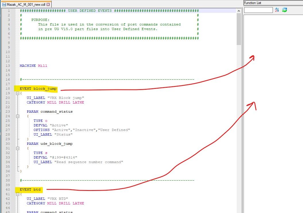

    How to add an new entry in the "FunctionList"?

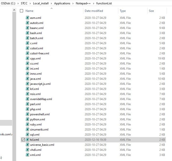

      PeterJones @Magnus Berglund
      @Magnus-Berglund ,
      If the directory listing you showed is accurate, you did not update overrideMap.xml. Without the pointer in that file, Notepad++ has no idea which functionList\___.xml file to use for the file ending in .tcl or .def .
      The contents of the overrideMap.xml are described in the user manual at https://npp-user-manual.org/docs/config-files/#v7-9-1-and-later-versions.
      But, in brief, for the three types you mentioned, you should have something like:
      <association id= "tcl.xml"				userDefinedLangName="TCL"/>
      <association id= "ude.xml"				userDefinedLangName="UDE"/>
      <association id= "def.xml"				userDefinedLangName="DEF"/>
      or, if they all use the same functionList definition,
      <association id= "tcl.xml"				userDefinedLangName="UDE"/>
      <association id= "tcl.xml"				userDefinedLangName="DEF"/>
      Either way, the name in the userDefinedLangName="..." should match the name you use for your UDL.
        @Magnus-Berglund ,
        I reread your original screenshots, and saw that you defined three different parsers in the same XML file. As of v7.9.1, each language gets its own file, so there should only be one <parser> tag per XML file. I would also separate those into three (thus meaning you use my first overrideMap.xml example.
        Also, even once you have that, it is possible that your regex need to be tweaked to accurately grab the “function names” for the Function List. If you are sure you have the files right (three parser XML files, plus editing the overrideMap to match), then provide us with the text (paste in your reply, highlight, then click on the </> button in the forum post editor toolbar) – because transcribing your XML from the images is error-prone on our part. If it doesn’t show up in the black box in the preview window, you haven’t gotten the </> button correctly applied to your example text.
        So if fixing the config arrangement works, let us know, and that’s great. If not, give us some stuff we can copy/paste and run experiments on our own.
        Good luck,
        Magnus BerglundM 1 Reply Last reply Reply Quote 0
        • Magnus BerglundM
          Magnus Berglund @PeterJones
          @PeterJones Thanks for the support!
          How can I upload a 7z file?
          (i’m new in this forum… ;-) )
          //magnus

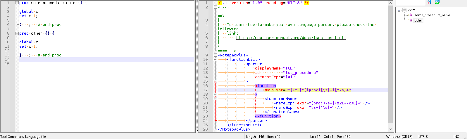

              @Magnus-Berglund ,

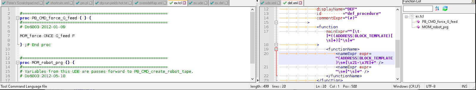

              So, since you hadn’t posted, I did try to implement the TCL. It works for me.
              However, there is the caveat: TCL is a built-in language, it just didn’t have the functionList bundled with Notepad++ (not all the built-in languages have functionList files, unfortunately). So you don’t actually need to add a UDL for TCL, and you don’t need to edit the overrideMap.xml, because TCL (language #29) by default maps to tcl.xml. You just need the functionList\tcl.xml to validly represent the procedure names.
              I took your regex and put them into tcl.xml, as seen below; I then re-loaded Notepad++, and opened ex.tcl file, with a simplified version of what was in your image, and it saw the two functions show up in the list.
              |   link:
              <NotepadPlus>
              	<functionList>
              			<parser
              				displayName="TCL"
              				id         ="tcl_procedure"
              				commentExpr="(#)"
              				<function
              					mainExpr="^[\t ]*((proc)[\s]+)[^\s]+"
              					<functionName>
              						<nameExpr expr="(proc)\s+[\x21-\x7E]+" />
              						<nameExpr expr="\s+[^\s]+" />
              					</functionName>
              				</function>
              			</parser>
              	</functionList>
              </NotepadPlus>

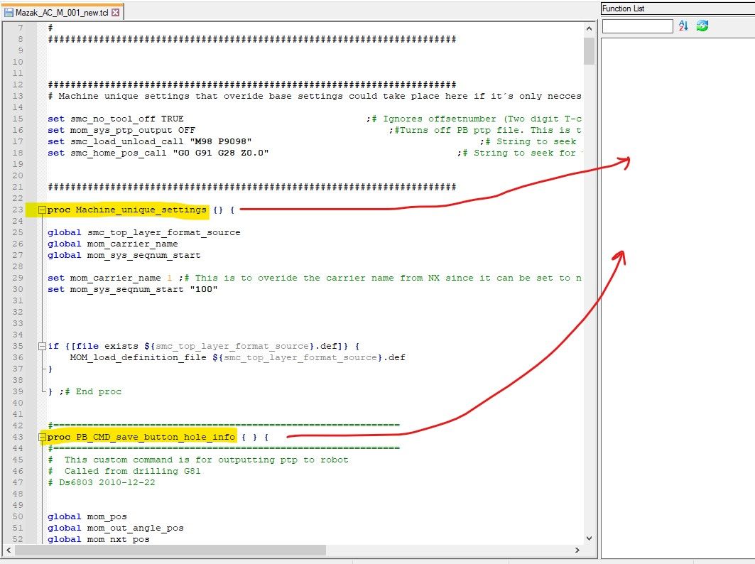

              • Magnus BerglundM
                Magnus Berglund
                @PeterJones , Sorry I needed to go home but up’n running again :-)
                Here’s a tcl example.
                proc PB_CMD_force_G_feed { } {
                # Ds6803 2012-01-09
                MOM_force ONCE G_feed F
                } ;# End proc
                proc MOM_robot_prg {} {
                # Variables from this UDE are passes forward to PB_CMD_create_robot_tape.
                # Ds6803 2012-05-18
                } ;# End proc

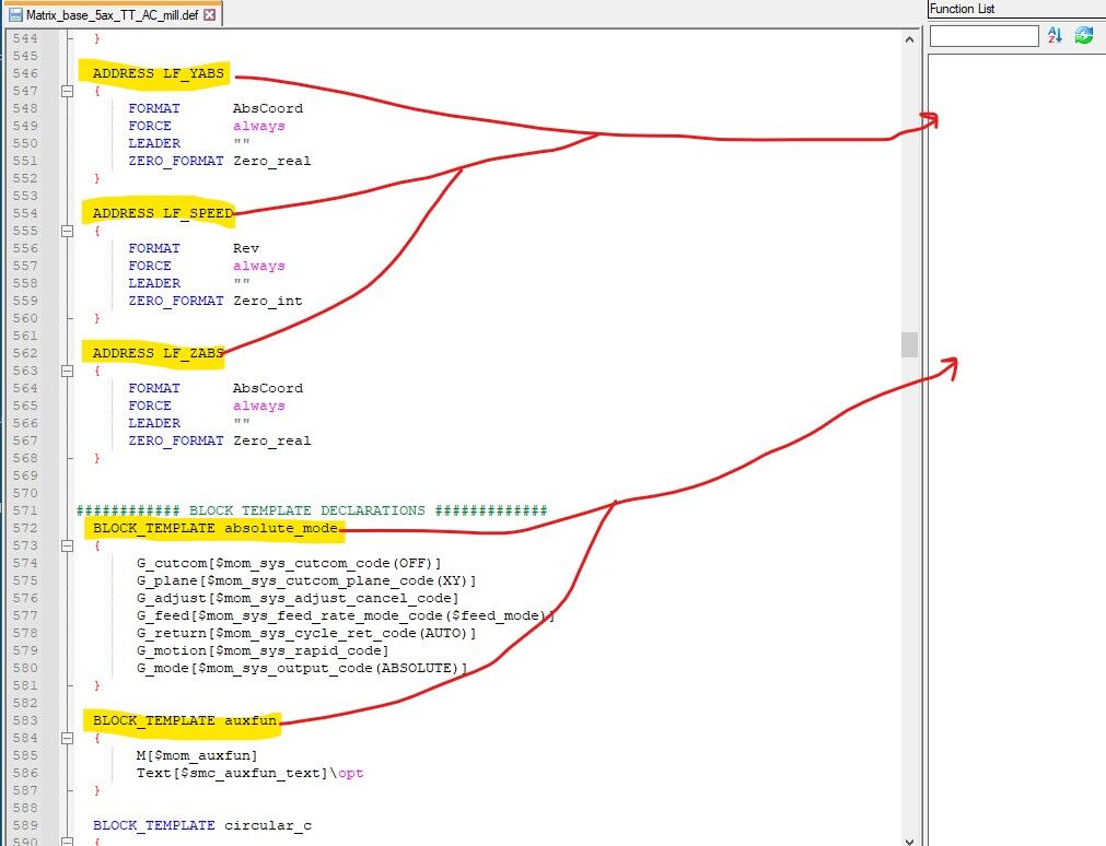

                and finally the DEF example
                  ADDRESS LF_SPEED
                      FORMAT      Rev
                      FORCE       always
                      LEADER      ""
                      ZERO_FORMAT Zero_int
                  ADDRESS LF_ZABS
                      FORMAT      AbsCoord
                      FORCE       always
                      LEADER      ""
                      ZERO_FORMAT Zero_real
                ############ BLOCK TEMPLATE DECLARATIONS #############
                  BLOCK_TEMPLATE absolute_mode
                       G_cutcom[$mom_sys_cutcom_code(OFF)]
                       G_plane[$mom_sys_cutcom_plane_code(XY)]
                       G_adjust[$mom_sys_adjust_cancel_code]
                       G_feed[$mom_sys_feed_rate_mode_code($feed_mode)]
                       G_return[$mom_sys_cycle_ret_code(AUTO)]
                       G_motion[$mom_sys_rapid_code]
                       G_mode[$mom_sys_output_code(ABSOLUTE)]
                  BLOCK_TEMPLATE auxfun
                       M[$mom_auxfun]
                       Text[$smc_auxfun_text]\opt
                  BLOCK_TEMPLATE circular_c
                       G_motion[$mom_sys_linear_code]
                       G_mode[$mom_sys_output_code($mom_output_mode)]\opt
                       fifth_axis[$mom_out_angle_pos(1)]
                       F[$feed]

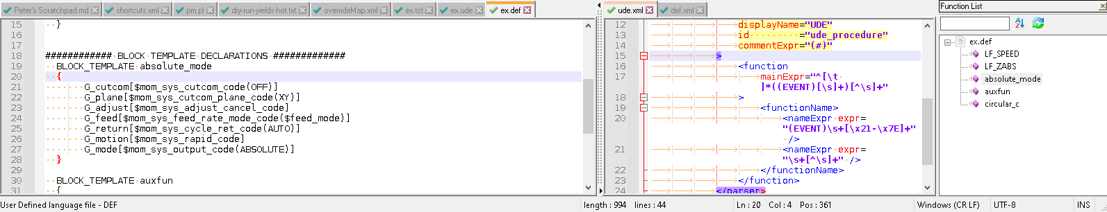

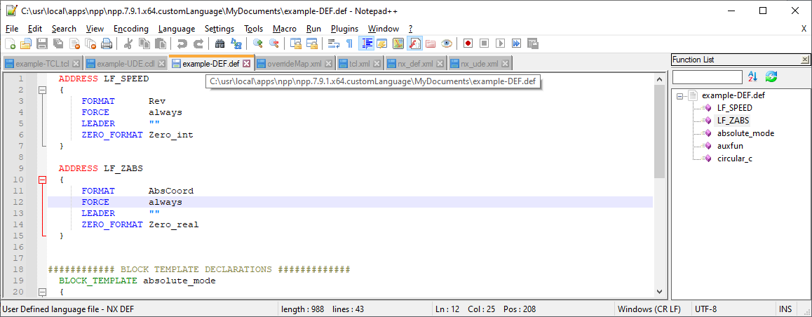

                  @Magnus-Berglund ,
                  All three work for me.
                  ude.xml:
                  |   link:
                  <NotepadPlus>
                  	<functionList>
                  			<parser
                  				displayName="UDE"
                  				id         ="ude_procedure"
                  				commentExpr="(#)"
                  				<function
                  					mainExpr="^[\t ]*((EVENT)[\s]+)[^\s]+"
                  					<functionName>
                  						<nameExpr expr="(EVENT)\s+[\x21-\x7E]+" />
                  					</functionName>
                  				</function>
                  			</parser>
                  	</functionList>
                  </NotepadPlus>
                  def.xml:
                  |   link:
                  <NotepadPlus>
                  	<functionList>
                  			<parser
                  				displayName="DEF"
                  				id         ="def_procedure"
                  				commentExpr="(#)"
                  				<function
                  					mainExpr="^[\t ]*((ADDRESS|BLOCK_TEMPLATE)[\s]+)[^\s]+"
                  					<functionName>
                  						<nameExpr expr="(ADDRESS|BLOCK_TEMPLATE)\s+[\x21-\x7E]+" />
                  					</functionName>
                  				</function>
                  			</parser>
                  	</functionList>
                  </NotepadPlus>
                  my overrideMap.xml has two new entries, next to the other UDL entries:
                  For my UDL definitions, I do not have a TCL UserDefinedLanguage, because TCL is a builtin language. I have a minimal UDL definition for UDE (all that’s saved is the extension = ude) and a minimal definition for the DEF (all that’s saved is the extension def). If I open your example TCL, UDE, or DEF files, they open associated as builtin TCL, user defined UDE, or user-defined DEF, and the functionList recognizes their functions, as shown in the screenshots above.

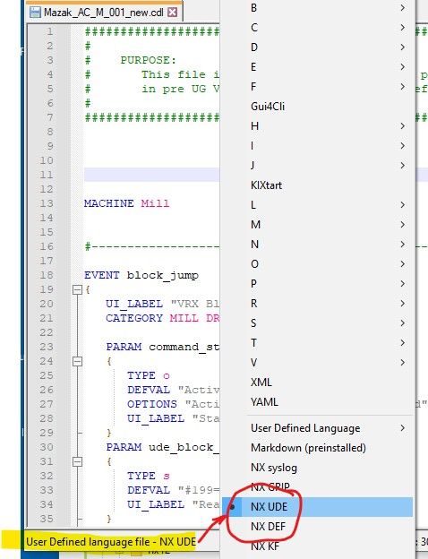

                  • Magnus BerglundM
                    Magnus Berglund

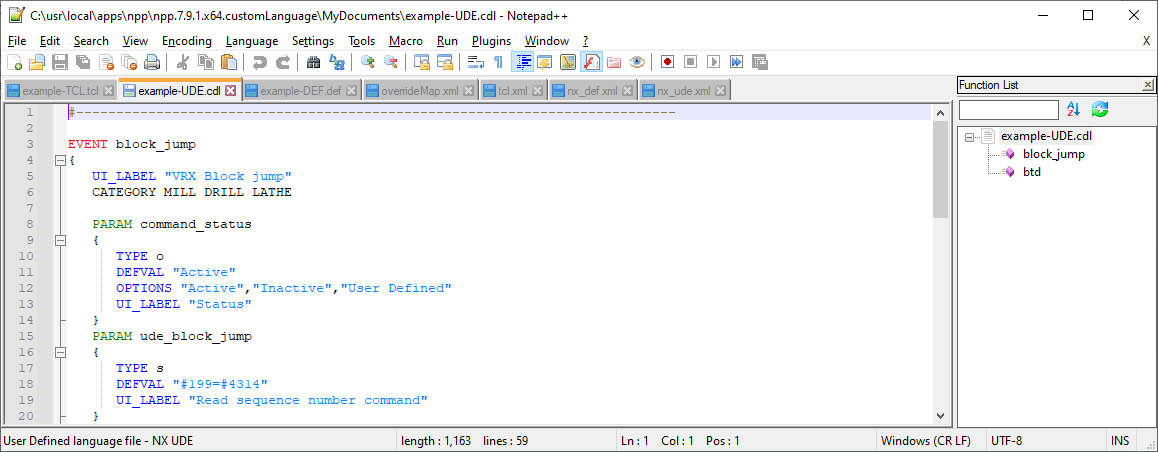

                    I’ve removed my “portable installation”, installed from “npp.7.9.1.Installer.x64.exe”, started NP++, closed NP++ and then copied the edited (as above) “ude.xml”, “def.xml” and “overrideMap.xml” to “C:\Users\me\AppData\Roaming\Notepad++\functionList”. Started NP++ and open a tcl file(or a def or a cdl) but nothing show up in the Functionlist.
                    I also uses a own “userDefineLang.xml”. Can this have impact on the FunctionList?
                      @Magnus-Berglund
                      Since your UDL are called “NX UDE” and “NX DEF”, change the overrideMap to match.
                      			<association id= "ude.xml"		userDefinedLangName="NX UDE"/>
                      			<association id= "def.xml"		userDefinedLangName="NX DEF"/>

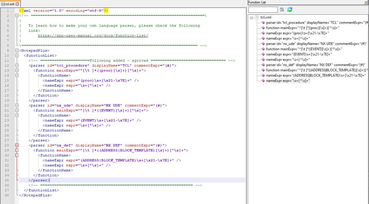

                      • Magnus BerglundM
                        Magnus Berglund
                        I tried but… :-(
                        below you see my files in the dir “C:\Users\me\AppData\Roaming\Notepad++\functionList”
                        def.xml
                        |   link:
                        <NotepadPlus>
                        	<functionList>
                        			<parser
                        				displayName="NX DEF"
                        				id         ="def_procedure"
                        				commentExpr="(#)"
                        				<function
                        					<functionName>
                        					</functionName>
                        				</function>
                        			</parser>
                        	</functionList>
                        </NotepadPlus>
                        ude.xml
                        |   link:
                        <NotepadPlus>
                        	<functionList>
                        			<parser
                        				displayName="NX UDE"
                        				id         ="ude_procedure"
                        				commentExpr="(#)"
                        				<function
                        					<functionName>
                        					</functionName>
                        				</function>
                        			</parser>
                        	</functionList>
                        </NotepadPlus>
                        and finally overrideMap.xml
                        <!-- ==================== User Defined Languages =============== -->
                        		<association id= "krl.xml"				userDefinedLangName="KRL"/>
                        		<association id= "sinumerik.xml"		userDefinedLangName="Sinumerik"/>
                        		<association id= "universe_basic.xml"	userDefinedLangName="UniVerse BASIC"/>
                        I’ll close for tonight and the weekend and made more tries during next week.
                        If You come up any idea what my issue is, I appriciate your support.
                        Thanks and have a nice weekend!
                          @Magnus-Berglund said in How to add an new entry in the "FunctionList"?:
                          Sorry, if I name my UDL “NX UDE”, assigned to the same .cdl extension your image showed, with the overrideMap and ude.xml as shown, it works for me. I cannot see what’s going wrong with yours.
                          Maybe this weekend, I’ll create a zipfile with the working Portable with the UDL and functionList , and put it temporarily on my website for you to download a working setup, and compare that to what you have. If I get that done, I’ll post a link

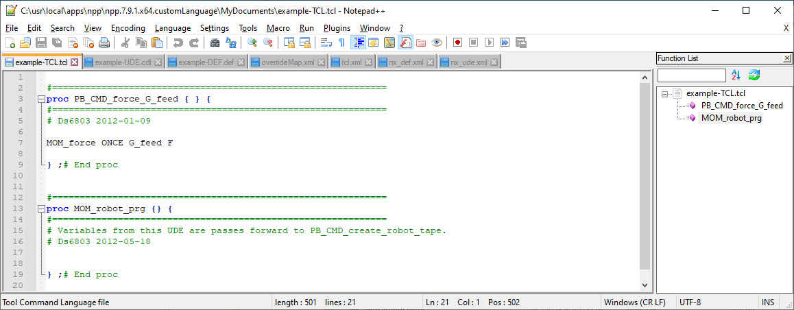

                            @Magnus-Berglund ,
                            here is a temporary link to a zipfile. This will unzip a portable Notepad++ v7.9.1-x64 which has an existing session with the example TCL, UDE, and DEF files open; the UDL is defined for NX UDE (.cdl) and NX DEF (.def). The functionList folder has files for tcl.xml, nx_ude.xml, nx_def.xml, and an updated overrideMap.xml which points to those file names.
                            For future readers: the download link may be invalid in the future; sorry.
                            When I use this portable, I see the following, showing that
                            (PS: I do not claim that my UDL definitions for those languages are any good; I just made a quick-and-dirty UDL for them to prove that the UDL was properly recognized; your UDL definition for those files is most likely much better than mine.)
                            • Magnus BerglundM
                              Magnus Berglund
                              Hello Peter,
                              What a fantastic zipfile! :-)
                              It works even for me, jippy!
                              Have a great Christmas together with your family
