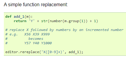

              You will likely have to resort to some sort of programming language solution to make that happen. Notepad++ supports some scripting languages as plugins which can do it. An example is the Pythonscript plugin, where the classic example of it is found in the documentation:
              In your case that code would be changed to be a bit more complicated:
              count = 0
              def add_1(m):
                  global count
                  count += 1
                  return ' ' + str(count)
              editor.rereplace(r'(?<=kamal)(?! \d)', add_1);

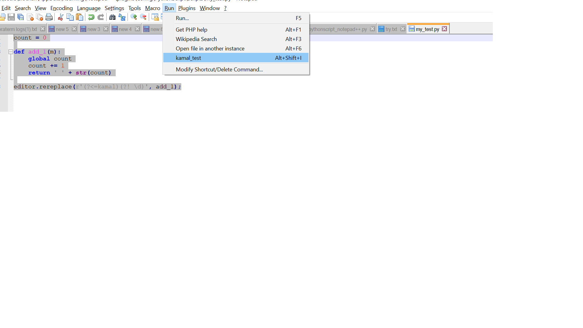

                • kamal lochanK
                  kamal lochan
                  ![alt text](![image url](1.png image url))
                  i am running python scripts in one tab and in other tab my text is present .
                  is thre any thing do i need to do?
                  • astrosofistaA
                    astrosofista @kamal lochan
                    Hi @kamal-lochan
                    Here are some basic hints for getting a Python script to run:
                    https://community.notepad-plus-plus.org/post/54655
                    Once the script is installed, select the text to process and run the script.
                    Have fun!
