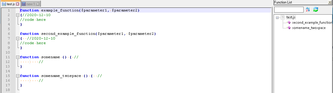

      Over the years I’ve developed a good habit of dating when I create functions. If there is a problem or “like” function I can read my technical journal or compare dates in addition to other options to help development along.
      There is an issue however when the formatting is as follows:
      function example_function($parameter1, $parameter2)
      {//2020-12-10
      //code here
      Currently the functions list will not display this function’s name while my date comment is on the next line even though the comment is after the opening { bracket.

        @jabcreations said in Functions list comment bug:
        This is known. Try adding a space between the open brace and your comment:
        { //2020-12-10
        I don’t know what language you’re using but that works for me in C/C++ (no space = no function in list, with the space = it shows up).

                PeterJones @Michael Vincent
                If it only required one space between the { and the //, I would be tempted to say “suck it up and deal”. I wouldn’t say it, but I would be tempted. 😉 But with requiring two spaces, that’s a bit much.
                I know that @MAPJe71 knew about the problem, and thus it’s technically known, but the FAQ entry didn’t link to an issue…
                Trying to search through, it appears that #3685 and others that are linked to that one all describe at least part of the problem. I’m not sure that any of them list both the conditions that @MAPJe71 put into the FAQ – and in fact, one of his comments implies that a single space was sufficient between the { and // in v7.6.3 – but in the FAQ and my experiments in v7.9.1, there are definitely still two spaces required:
                And, my initial joking aside, telling people to “just suck it up and deal”, when maybe their corporate style guide requires zero spaces between the opening { and the comment showing the date (or whatever other comment the style guide requires), doesn’t seem like a good idea. Even if it’s not a corporate mandate, forcing people to change their coding style to accommodate a quirk (bug) in an editor seems rather the wrong way around.
                (With a single space, I can understand the coding argument inside the application: “it’s harder to distinguish between a single-unit {// and { //, when my parser was already written to require a boundary of some sort between tokens”. But to require two whitespace between the brace and the comment is going a bit far.)
                @MAPJe71 , do you have any insight into the code, as to why it’s requiring two spaces. I saw that in some of the comments in the issues, you had mentioned it was caused by an offset in the function list search code. But a single offset doesn’t jive with what you say in the FAQ, and what my v7.9.1 screenshot just showed: that for brace-to-comment, there have to be two spaces, not just one. If you have insight into the code that does that parsing, does it look like it’s a solvable problem? Or are we going to be stuck with it for all eternity? If it looks solvable, is there a way we could post a suggestion for how to solve it in one (or more) of those open issues, and see if we can get some traction on getting that fixed?
                I’m at least posting a bump on #3685 .

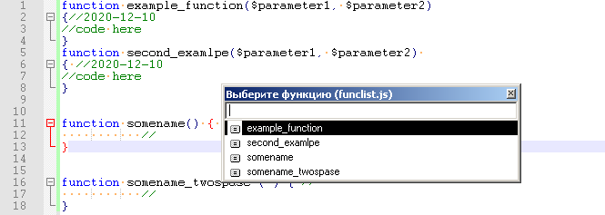

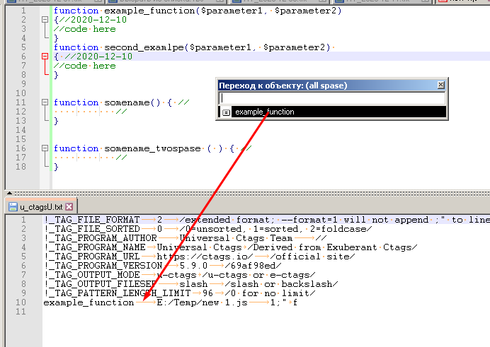

                • TroshinDVT
                  TroshinDV
                  Perhaps it is worth considering the option of using the ctags output (https://ru.wikipedia.org/wiki/Ctags) to build a list of functions, as I did in the project https://github.com/trdm/jn-npp-scripts
                  I have been parsing texts for several years and I know that regular expressions have their limitations.
                  True, I have not yet mastered the full power of boost RegEx and cannot judge their effectiveness.
                  • TroshinDVT
                    TroshinDV
                    Oops …
                    ctags is not very efficient.
                    It’s good that there is a fallback :)

                                PeterJones @jabcreations
                                @PeterJones I understand the lack of desire to rewrite though is the regex at least per language or is it some suicidal everything-must-be-the-same madness? I’m all for reusable code (ours is very dynamic) though there are limits, human limits.
                                In terms of the user-configurable regex, it’s per language. I don’t know about the internals, but it’s presumably the same wrapper for every language on the inside, and just makes use of the user-configurable regex per-language. But the code that @Michael-Vincent pointed you to is the only way to know for sure (and I’ve never looked at it)
