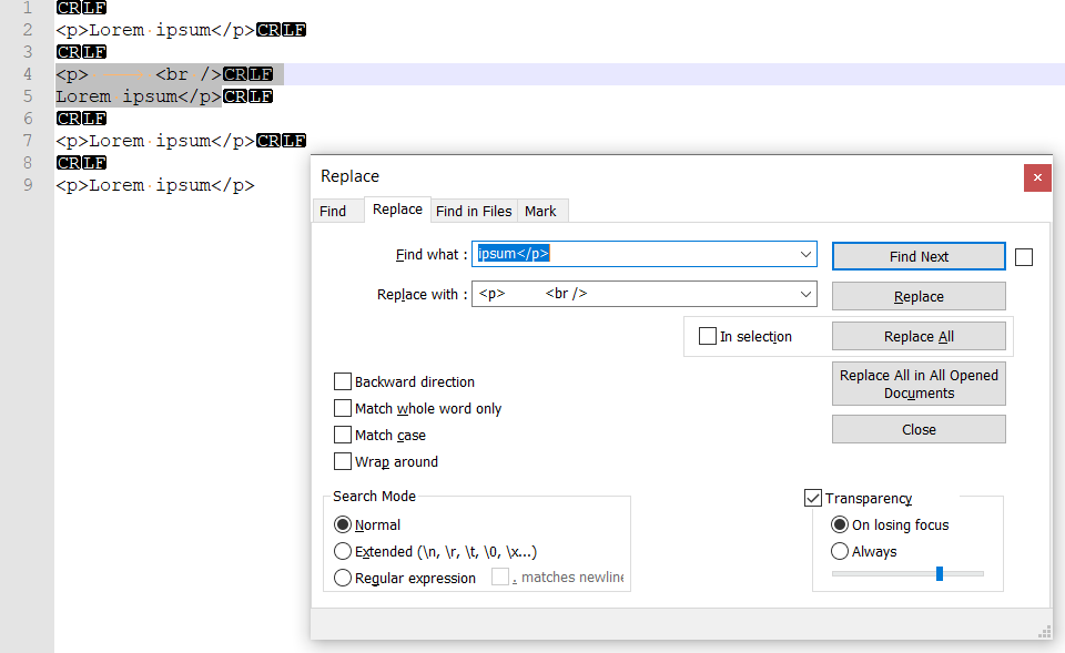

      Baffled here. Suddenly I cannot paste from text to search and replace. Please see the screen cap. If I select
      ipsum</p>
      and would like to replace them with
      <p> 	 <br />
      Lorem ipsum</p>
      only the characters in from the first row appear to replace with field. Why doesn’t it copy past the first line? Just a few days ago I was able to copy and paste multiple lines without an issue and I don’t recall changing anything. Pasting to anywhere else gives all the lines. Any help appreciated.
        Alan Kilborn @Tuomas J. Alaterä
        @Tuomas-J-Alaterä
        Nope, you are remembering wrongly.
        Notepad++ has never supported paste of multiple lines into the Replace with field.
        The way to do it is with regular expressions and putting desired_line_1\r\ndesired_line_2\r\n in the Replace with box.

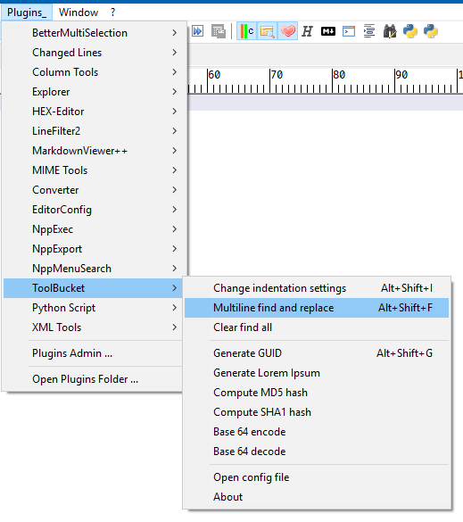

                  The ToolBucket plugin can do it…maybe keep you in Notepad++? :-)
                    Checking that out now, thanks. Looks perfect for the job. Sounds like I rather stay than leave!

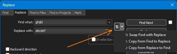

                                  Multiline search and replace was a big issue when this thread was originally created; now it isn’t such a large problem, because of the advent of the “swap” widget/control:
                                  It’s ALWAYS been possible to get multiline data into Find what if you select it and press Ctrl+h (or Ctrl+f), so if you need multiline data in Replace with you can select it (the replacement text) first, do Ctrl+h on it, then Copy from Find to Replace, then select your true Find what text and invoke Ctrl+h again.
                                  Kinda klunky, but it works.
