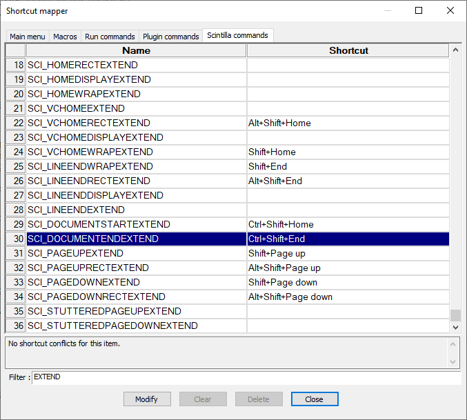

          There’s a way to select from the cursor to the end or beginning of the file, by default with Shift+Ctrl+END or Shift+Ctrl+HOME
          With “normal” size files, those work find, followed by DELETE or BACKSPACE to delete them.

                    @PeterJones: That 2 shortcuts work best for me - I don’t just want to keep the cursorline.
                    Sorry for my stupid question - thread is solved. And the solution is very simple…
                    Thanks a lot!
