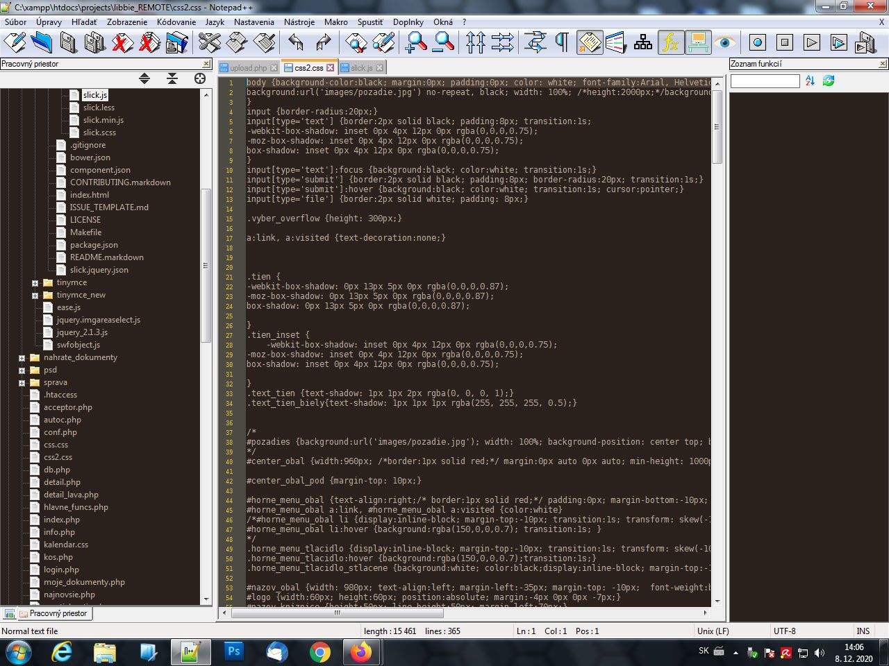

              Here is my scr :screen.jpg
              btw im using slightly edited bespin theme … thanx
              • Celestin NohaC
                Celestin Noha
                i see it now … its open as normal text file but only if recent files are open

                  I have never seen Notepad++ open the file as the wrong type, even if “recent files are open”.
                  Well, let me append: unless I had manually tweaked the Language setting for an open file, then closed Notepad++ and re-opened (so that Notepad++ remembers that you forced the language to Normal text file)
                  I recommend that on any files that are wrongly Normal text file that you go to the Language menu and pick the right language for that file. Notepad++ will remember that setting from run to run, as long as it’s using the same session (Settings > Preferences > Backup > ☑ Remember current session for next launch).
                  If I force a CSS file to Normal text file, then exit Notepad++ and re-run, it remembers the wrong highlighter. But if it’s forced to Normal then I close the file (without exiting Notepad++ too), I can re-open the file in Notepad++ and it will go back to being highlighted as CSS.
                  If it continues to show files under the wrong type, maybe you’ve got conflicting extensions in the Style Configurator’s User ext.: box for some languages, or some other strange configuration bug. Or maybe a plugin is interfering with file detection. Sharing your ?-menu Debug Info might give some insight to us. Also, if you have a reliable sequence that always gets the file to open wrongly as Normal text file, if you could give us the exact sequence (making sure to include things like whether you open the file by using the Folder as Workspace you show on the left, or whether you use File > Open, or whether you use the Windows Explorer to drag the file into Notepad++, or double-click in Windows Explorer, or RightClick > Open in Notepad++ or some other sequence to open the file).
