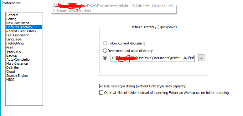

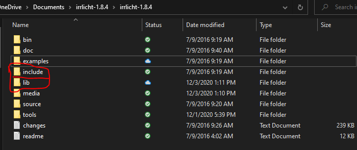

      Rrrrrright, so ‘ere’s the sitch. Tryin’ to launch a Game Engine usin’ Notepad++. ‘Course, this requires me to transform the text editor into an IDE by downloadin’ a C++ compiler. Problem’s that no matter what I try, I cannot seem to get the compiler to read the necessary files or directories. I can only find a settin’ for the Default Directory…
      …but I need to use 2 directories in order to get it to run.
      So is there any way for this to be done, and if so, how?

        Ekopalypse @Vyrre
        @Vyrre
        no, these settings change npp internal behavior for
        functions like find dialog etc…, these are not intended for
        building/simulating an IDE.
        I would recommend to use the excellent NppExec plugin
        which allows you to create different profiles to run different commands.
