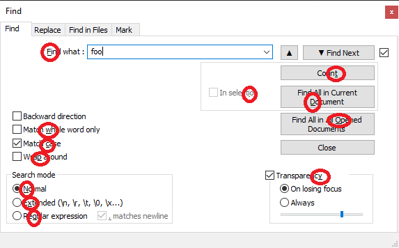

        Michael Vincent @Sebastian Freeh
        @Sebastian-Freeh said in Is there a shortcut for starting search in different search modes, e.g. normal and regex search mode?:
        1. is there any way to switch from normal search mode to regex search mode using a shortcut after opening the serach with ctrl-F?
        Yes.
        • Alt-N = Normal search
        • Alt-X = Extended
        • Alt-G = Regular expression.
        In fact, Alt+ any underlined letter on text items in the Find dialog will activate that component.

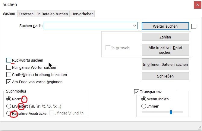

          When I use English as localization that works perfectly!
          When I swith to german however, my native language, the unterlined characters are a bit different:
          ALT-l for normal
          ALT-i for extended
          ALT-R for regex (but ambiguoesly also used for backwards search (Rückwärts suchen))
          When I press ALT-i it works perfectly fine and activates the radio button.
          When pressing ALT-l or ALT-R however, the marker jumps to normal (in german Normal) but the radio button is not activated. Pressing ENTER does not activate the radio button. Is there any way to to toggle the radio button when the marker is on it?
          Switching to english localization is not an option in the long-term…
          Thanks for any ideas

              Alan Kilborn @Sebastian Freeh
              Space bar press+release?
              By “marker” I presume you mean the indication that shows you you have input focus on a certain control?
              Sebastian FreehS 1 Reply Last reply Reply Quote 3
              • Sebastian FreehS
                Sebastian Freeh @Alan Kilborn
                Thanks! That worked like a charme!
                Yes, that’s exactly what I meant
