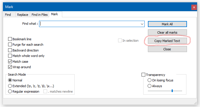

                        The new thought is that, at the time of the “Marked Text Manipulation” thread’s main discussion, there was no way to copy marked text without resorting to scripting. Now (7.9.1-ish) there is:
                        Just press the indicated button after you already have marked some text.
                        I will put a similar not in that other thread as well.
                          Hi, @anthony-noriega, @alan-kilborn, @terry-r and All,
                          Oh, yes, Alan. You’re right ! Of course, I already downloaded the portable v7.9.1 version but I’m still “stuck” with the v7.8.5 version which explains why I didn"t notice this recent enhancement !
                          So, thanks to @scott-sumner, we just have to use the (?-s)/\.\*\K(.+?)(?=\.\*/) regex, click on the Mark All button to get all the keywords and, then, click on the Copy Marked Text button and paste the results on a new document. Nice !
