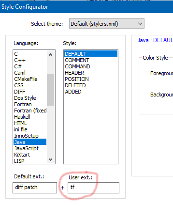

          Hi thanks for replying. As of right now I don’t have enough time to undertake this project, so I leave this as a challenge for someone who has free time on their hands.
          I noticed that if I select Java language for the .tf file it highlights well enough. Is there a way to associate .tf files with Java language by default so I don’t have to manually associate the language for every file? Thanks.
            Alan Kilborn @carlosvsilva
            @carlosvsilva said in Terraform HCL syntax highlighting support:
            I believe going to the Settings menu and choosing Style Configurator… and setting this up will do the job:
            carlosvsilvaC 1 Reply Last reply Reply Quote 2
            • carlosvsilvaC
              carlosvsilva @Alan Kilborn
              @Alan-Kilborn Thanks that worked. But how do I preload the Jenkinsfile UDL for all files named “Jenkinsfile” (note the lack of extension)? I would like to know that so I can also preload Makefile style for Makefile’s, etc

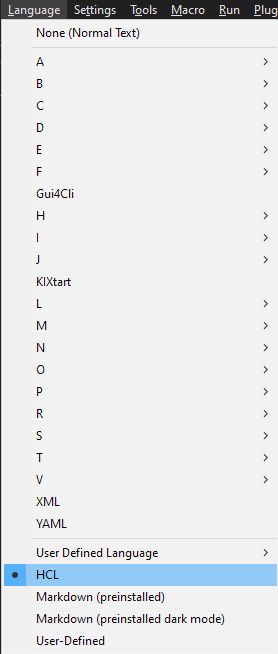

                                I know this thread is old, but it’s come up as the top hit in web searches periodically over the past year, so I figured I’d post a reply here.
                                I configured a user-defined language for HCL - at least a fledgling one - based on the documentation references that @PeterJones cites in the second post in this thread, as well as a cursory review of the HCL language spec. The relevant configuration is posted below, with the following caveats:
                                • I barely know HCL, this is my first Notepad++ UDL, and I’ve only spent about 2 hours on this so far, so set your expectations accordingly
                                  • I’m posting this draft UDL in case it might help others get started, but…
                                  • I’m not planning to maintain this as a project, so please don’t request fixes/enhancements
                                • I defined the new language using the Notepad++ 8.1.9.1 Language > User Defined Language > Define your language dialog
                                  • Accordingly, the configuration below was persisted in my %APPDATA%\Notepad++\userDefineLang.xml file
                                    • Another thread I read said that this is the old way of storing UDLs (the new way being the userDefinedLang directory) but the doc states that this is the method the configurator dialog uses, so voila
                                • I’m using dark mode with some global overrides, so you may need to change the colors just to make them readable if you’re using a light-colored background
                                • Two limits of which I’m aware are:
                                  • Folding doesn’t work. This seems to be due to the fact that I’ve defined curly braces as the folding delimiter, but also as operators and in another delimiter (I can’t explain it better than that at the moment).
                                  • Heredocs aren’t formatted specially, like you get with the built-in “shell” language, for example. I think that UDL just doesn’t support heredocs - but it’s equally likely that I just don’t know how to do it.
                                You should be able to add the following to your userDefineLang.xml file (creating the file, if necessary) and restart Notepad++. Once you do, you should see a new “HCL” choice at the bottom of the Language menu (note that this won’t show up under the “H” sub-menu along with the built-in languages):
                                Here’s the content of my userDefineLang.xml file:
