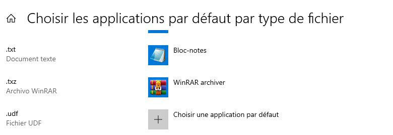

          i installed the Notepad++
          I installed a lot of plugins from Notepad++ settings
          i open any txt with the notepad++ but every time i open notepad++ gives me a lot of errors with the plugins
          so i remove it
          now i dont have it in my computer and i’ve unintalled and i delete the folder too fro program files
          now when i try to open any of the txt in my computer with the windows 10 “bloc de Notas” gives me the error “Please Reinstall the NotepadStarter”
          So i dont have the notepad++installed in my computer and i can not open the txt files…
          I’ve tryed to install again the notepad++ without any plugin but gives me the same error and now i can’t open the txt not even with notepad++ and not even with the windows 10 app “Bloc de NOtas”
          ![alt text](Capture d’écran 2020-11-06 193752.png image url)
          Thanx for help :)

            You might want to download the uninstall batch file (https://raw.githubusercontent.com/lygstate/NotepadStarter/master/starter/NotepadStarterUninstall.bat) and try running it, and see if it gets rid of your error.
            Beyond that, someone else will have to jump in, because I don’t have any more ideas or experience with this.

              I would reinstall Notepad++, then I’d add the NotepadStarter plugin from the ‘Plugins > Plugins Admin…’ menu. Once these two are installed I’d follow @PeterJones advice and try to run the batch file:
              1. Go to ‘Plugins > Open Plugins Folder…’
              2. The folder with Notepad++'s plugins will open. Go to the folder ‘NotepadStarter’
              3. Click on the file ‘NotepadStarterUninstall.bat’
              Hopefully this action will fix your computer and you will be able to open txt files with your Windows 10 notepad.
              If that worked, feel free to keep notepad++ (or not), but personally I would go back to Notepad++'s ‘Plugin Admin’ and Remove NotepadStarter…

                @litos81 Hiiii !!! It worksss ! Thank you very much!
