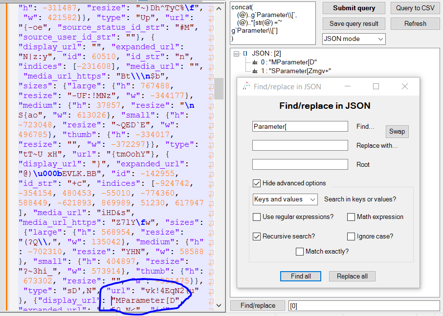

@Auryn-Me said in put search result right in the middle of screen:
I have JSON files where 1 line is thousands of character long.
I need to search for something (let’s say “Parameter[”) and then change what is next and this x times on the same lineYou might find the JsonTools plugin useful.
Example usage (using a randomly generated “tweet” using a Twitter’s API schema):
The tree view above the
Find/replace in JSONdialog box shows a list of results, and when you click on a node in the tree (or navigate to that node using the arrow keys after selecting another node), the caret jumps to the location of the corresponding text in the document, as shown above. -

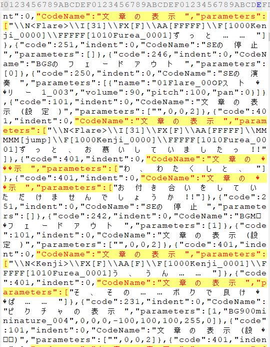

Thanks to boths.
Sadly it seems i under estimated how complicated this JSON will become.
I am trying to translate a game from japanese to english but the text is interleaved with formatting “codes” and graphics/sound calls. It seemed that by searching “CodeName”:“文章の表示”,“parameters”:[ (that japanese text meaning “Display of text”) I would find the text just after it (see the bottom hit).
Sadly as you can see on the first hit, it is not the case because after my search there are more “calls” before the text and by parsing the JSON in this Hex editor, i saw that there are even text without the part i was searching. I probably need to slowly parse it by hand :(
And yes, not all japanese text has to be translated because example SExxxx/BGSxxxxx are sound effect and background sounds.
Thanks anyway."

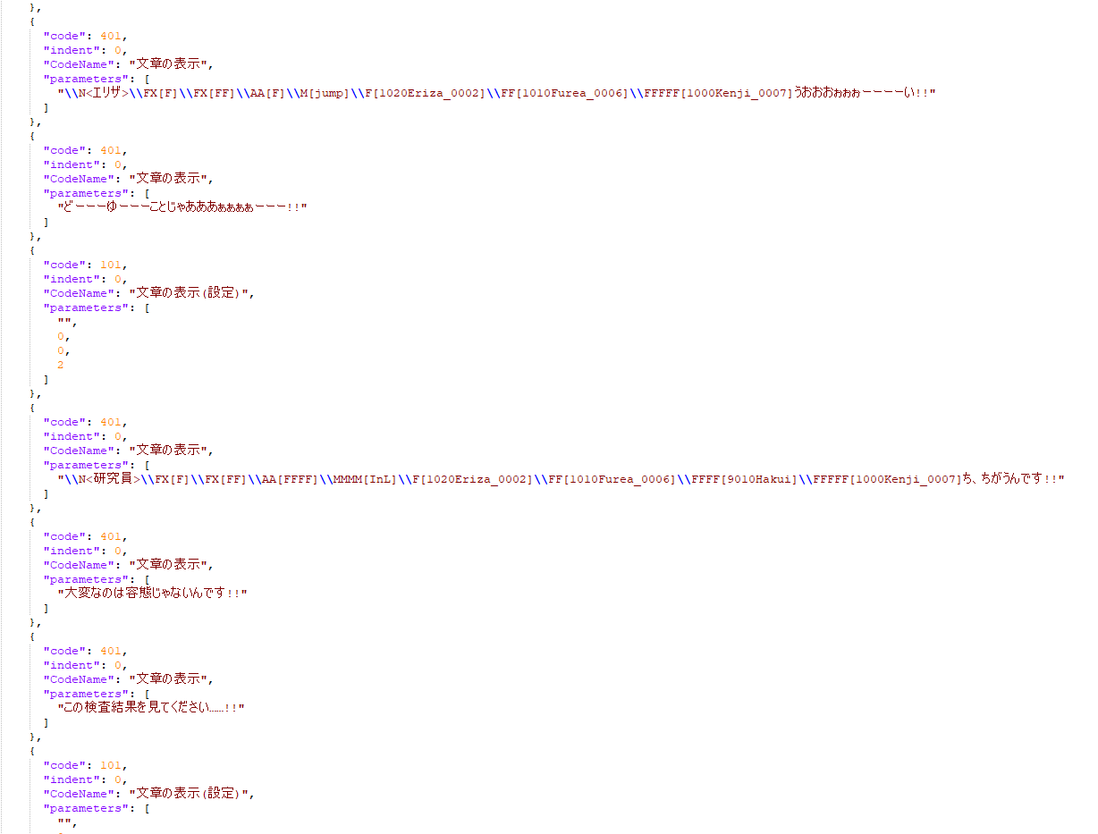

I got progress :)
I found a JSON Formatter / Validator that formatted that mess from above to this:
Look much more easy to work with, the game accepts it and i can use Notepad++ :)
