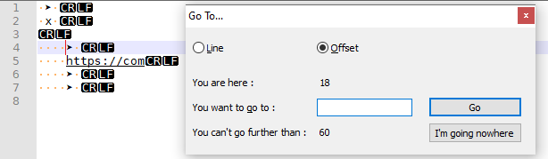

        Even in this example:
         x
            https://com
        … where the cursor is at offset 18, shown in red: if I try to go to offset 19,20, or 21, it places the cursor after the ➤ (those are the three byte offsets for the UTF8 encoding of that character), and 22 places it after the space.
        So I don’t know how you convinced it to break that character apart. Also, ➤ is U+27A4, so it’s three bytes should be 0xE2, 0x9E, 0xA4… so your screenshot shows that it took the two outer bytes, but the central byte is apparently missing.
        Ooh, that gave me a hint: in my example, if I go to offset 19 then hit DEL, it changed to
        So I am guessing what happened is that you somehow got it to the central offset in the multi-byte character and deleted it – though for me, UNDO works to fix that. So maybe you triggered a script which deleted the byte from the character but plays with the UNDO history so UNDO didn’t work.
