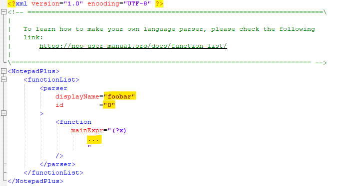

      Then I created a new file called, somewhat obviously, normaltext.xml in the ...\functionList\ folder; here’s what that new file looks like:
      (I had copied a simple file in the same folder to have a template to make my new file – I chose asm.xml and removed the “assembly language” specific stuff before I started adding my own stuff.)
      I highlighted in yellow the things I changed:
      I used id = "0" because I know from my previous function-list configuration efforts that zero is the id for normal-text.
      For the displayName= I just put a dummy name in; not sure if/where this value would be used by Notepad++ (but what I did didn’t affect how the function-list feature worked, so…good!)
      For the ... part, I put in my own particular function-list regular expression.
      After doing this, and restarting Notepad++, when I looked at a .txt file that my stuff was working for under the old scheme (7.9), I had success under 7.9.1 !

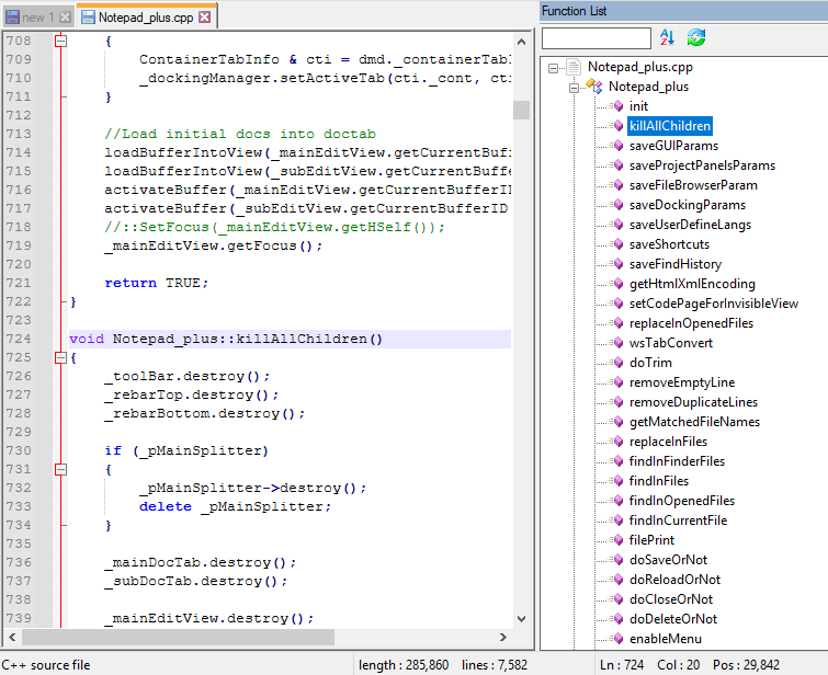

              So, for a N++ source file, here’s an example of what you might see:
              Here, init, killAllChildren, etc. are the functions.
              Doubleclicking on a function name in this window will jump you in the source code to the definition of that function.

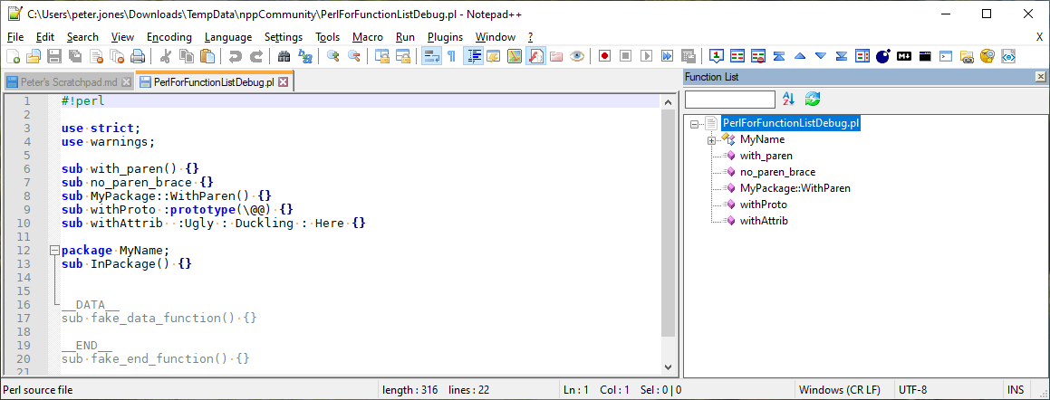

                            If you pick a pre-supported programming language, and open a file of that type (so the Language menu shows it properly selected and the status bar agrees), then the function list will show the defined functions. For example, if I open PerlForFunctionListDebug.pl
                            #!perl
                            use strict;
                            use warnings;
                            sub with_paren() {}
                            sub no_paren_brace {}
                            sub MyPackage::WithParen() {}
                            sub withProto :prototype(\@@) {}
                            sub withAttrib  :Ugly : Duckling : Here {}
                            package MyName;
                            sub InPackage() {}
                            __DATA__
                            sub fake_data_function() {}
                            __END__
                            sub fake_end_function() {}
                            … then I see:

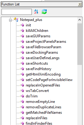

                              Why don’t you download Notepad_plus.cpp from HERE by right-clicking its contents and doing a SaveAs in your browser, and then open this file in Notepad++?
                              Then you should see the following, which MIGHT help you understand this feature by looking at the following:
