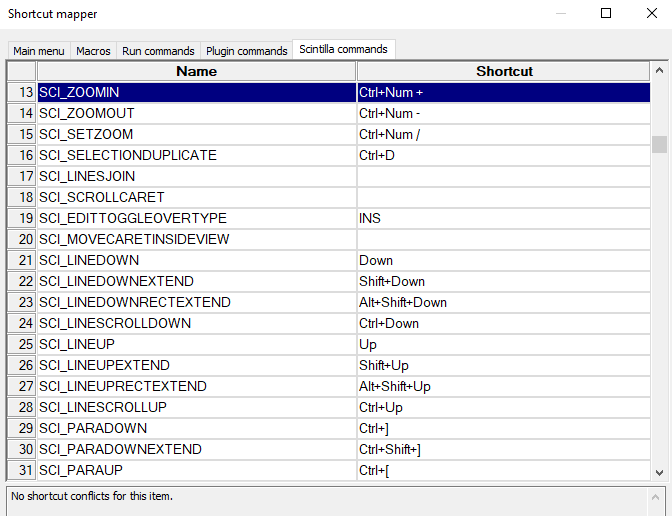

        Does the shortcut mapper show any conflict on the Scinitilla commands tab for SCI_ZOOMIN, SCI_ZOOMOUT, SCI_SETZOOM (the text at the bottom shows whether or not there are conflicts)?
            no
