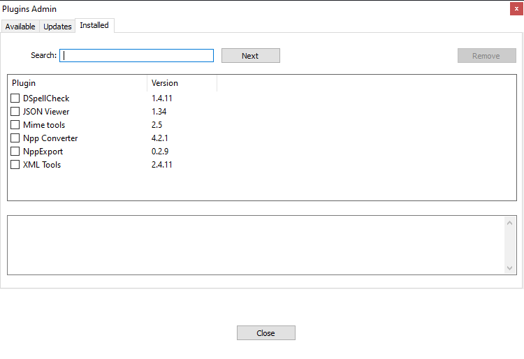

      I’ve read that addons sometimes can cause stuff like this, although i haven’t found my exact issue.
      My current addons list is as follows:

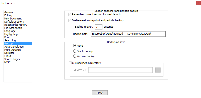

      The only thing i can think being a bit atypical i have compared to the average Np++ install is that my config files are being saved/loaded in/from my dropbox folder, so i can get any changes on all my devices:
      Any idea what may be causing it? Is there any .log file i can check and see what’s causing the hang?

        Try to update the “DSpellCheck” plugin, and then disable all plugins at all.
        https://github.com/Predelnik/DSpellCheck/releases/tag/v1.4.18

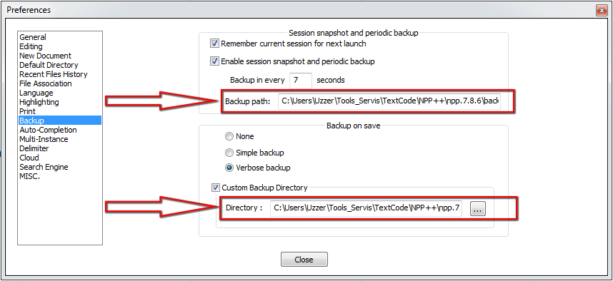

          Configuration files cannot be here!
          These are the backups of your session files)).

            VL4DST3R @andrecool-68
            @andrecool-68 Wait, cannot be “here” where, exactly? On dropbox? Just to be clear, it’s still a regular folder and path on my drive, and npp can access it just fine.
            I’ve indeed updated my plugins right after i posted this (something i realised i haven’t done in a long time) and since then it hasn’t happened again, butt as i said, it doesn’t happen that often. Will return if it does happen again again, but let’s hope it was just an outdated plugin, albeit with a very strange way to manifest itself (by randomly freezing like that)…
