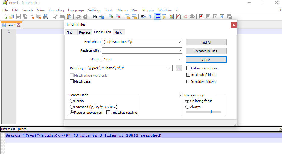

        Change your Search mode to Regular expression and set your Find what box to (?-s)^<studio>.*\R and set the Replace with box to be empty.

            That didn’t work.
            I am seeing a progress bar going through all the nfo’s, but it is not removing the lines
            Not pretending to understand how this works, but is it possible that the ‘Find What’ field is searching the name of the nfo, rather than inside the nfo?
            Screenshot of notepad:

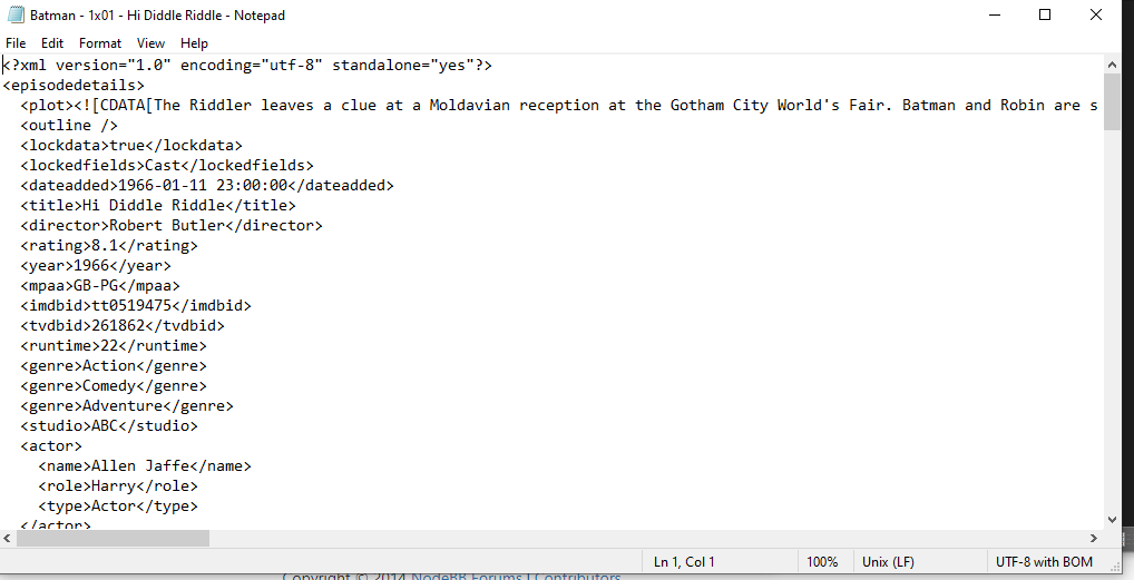

            Screenshot of one of the nfo files after scan is complete:

              Your example shows the string <studio> is indented, but your search string needs it hard against the left margin.
              I’d suggest adding \h+ just after the ^. This means one or more horizontal spaces.
