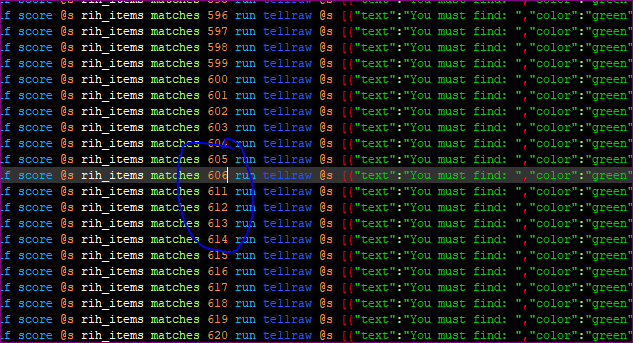

      it is possible to correct the string or continuation of number ?

              on the screen i’ve made you see 606,611,612 etc… but i want to correct it in all the doc after 606 it have 607 608 etc…
              and i don’t want to replace values with my hand because i have ~300 value ,it have solution or answer on my topic or not ?

                @Josianne-Michel said in Possibly correct string or continuation:
                By looking at your image an option to this problem would be to work in ‘Column mode’. It can be activated by the combinations Alt+Mouse Selection or Alt+Shift+Arrow key. Then:
                1. you select the column of numbers starting from 611 all the way till the end (999?)
                2. Go to the ‘Column Editor…’ option (menu Edit) or pressing Alt+C.
                3. In the Column Editor dialog, select the option ‘Number to Insert’, set the ‘Initial number’ to 607 and the ‘Increase by’ to 1. Click OK
