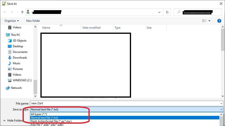

              Michael Vincent @alexolog
              @alexolog
              All filters are always all available. It’s a matter of which one you want to show up in the “Save as type” combo box.
              Personally, I prefer Notepad++ to “auto-assume” I want the extension based on the language I am editing in.
              Of course, for new files, this presents a dilemma since no language can be assumed. For me, this not an issue since I don’t write an entire new file in some language without first going to the Language menu and selecting that language so I get proper lexing while coding.
              The default is “Normal Text” - see this by opening a File => New and notice the bottom left status bar says “Normal text file” and the menu Language => N => Normal Text is checked. So now, when saving, Notepad++ will “auto-assume” you want Normal Text and automatically select the “Save as type” to Normal text file (*.txt). Note, you can easily use the combo box pull down to select another file type - or just scroll it up 1 single entry to find the All types (*.*):
              As I understand the commit I referenced above and as @Alan-Kilborn explains it - you will now have a checkbox to make All types (*.*) the default “auto-assumed” type for Notepad++ Save As…
