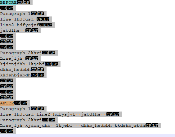

          OK ,
          Please find attached image![alt text](ohm dios.png image url))
          • Ohm DiosO
            Ohm Dios @PeterJones
            Hi ,
            I have updated my query. Please have a look and do the needful please. thanks.

              Even with those screenshots, the only thing I can tell about the CRLF that you want to keep are the ones before the word Paragraph and at the line of the line containing the word Paragraph, but I am doubtful that I have correctly guessed your intended meaning (in that, I doubt the word Paragraph is actually anywhere in your text). Other than that, I have no way of determining which CRLF you want to keep and which CRLF you want to remove. What is the rule that decides whether a line should be joined or not?
              If you don’t have a hard-and-fast rule, then regex won’t be able to help you.
              Either way, I might suggest just highlighting the lines that you want to join manually, and use Ctrl+J (Edit > Line Operations > Join) to join the lines.
              Ohm DiosO 1 Reply Last reply Reply Quote 1
              • Ohm DiosO
                Yes Sir, You got my point ctrl+j But i dont want to go each and every paragraph to join. I need a regex command to do it all at once as per given string of start word and end word. It has to select all the lines between two strings and join keeping only end CRLF .
                Your query-Which CRLF To Keep–> Paragraph 1 CRLF (All lines wraped) CRLF …Next Paragraph
                To Remove --> Inside [ Startword.CRLF ( all lines).CRLF.endword]
                Hope you understand now.
                Thanks.
