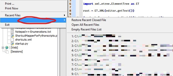

      I have a “blank” item in my File menu:
      The Recent Files item just above it appears the same when expanded:
      Any ideas how to fix?
      (Meaning how to remove the “blank” one)

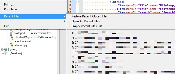

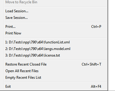

        Ekopalypse @Alan Kilborn
        I don’t have that layout (freshly unpacked portable version).

          The menu Alan showed for his unnamed > submenu is what I see in my Recent Files > submenu, if Settings > Preferences > Recent Files History > In Submenu is enabled. But I see just the one Recent Files >, without the second unnamed > submenu. If that option is disabled (default condition), I have a menu similar to what @Ekopalypse showed.
          Maybe Alan has that enabled, and his playing around with english_customizable.xml has confused somethnig
          EkopalypseE Alan KilbornA 2 Replies Last reply Reply Quote 2
            ha, never noticed this one before.

              I haven’t seen how any “hacking” of english_customizable.xml could get an extra menu entry created.
              I suppose one could set an entry’s caption to be "" in the xml, although I haven’t done that and don’t see the use.
              Plus, this is fairly obviously a duplicated menu entry somehow, which I tried to make clear in the screenshots.
