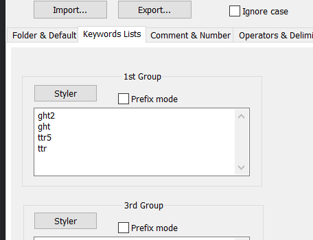

 Good day to everyone. I managed to somehow add my first UDL in Notepad++ v7.8.9 but one thing still concern me too much to start using it just right now… So here’s the deal. I’m using some specified keywords like “ScriptItemActObject1”, “t_OnAnotherItem2” and so on. They are contained a number on their tails. I cannot rename this keywords, so I really need to adapt them for normal work with UDL.

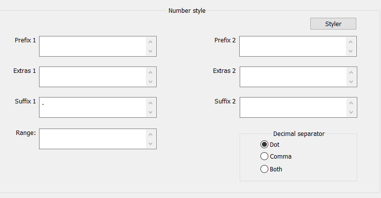

 Still, then I’m trying to do that, Notepad is just giving me huge bag of frustration. Since I read many topics about “How hard to add correct prefix/suffix” to the numbers highlight, I was never expecting to this:

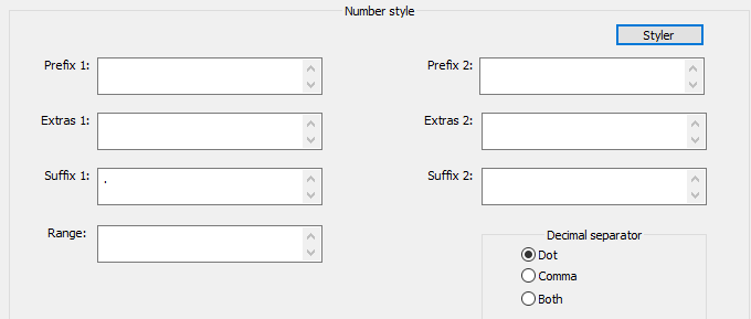

 As you may see, numbers here got the priority over my keywords, but I can’t really understand why. It seems even more frustrating, since I never added any additional symbols to number highlights (instead of one “.”) at all:
  Any possible recommendations are welcomed.

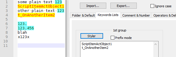

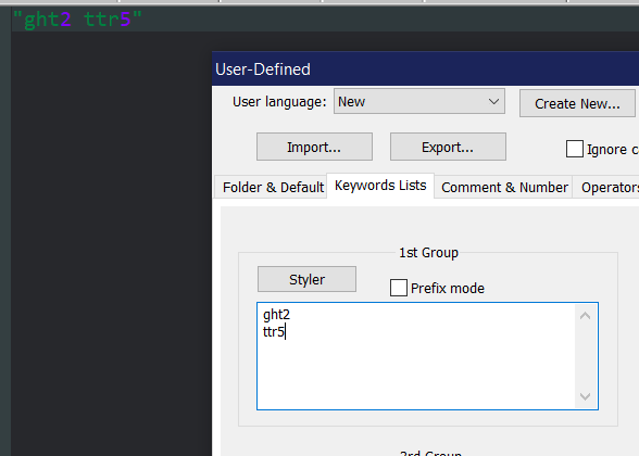

 @Ivan-Karpov said in UDL numbers problem: I am not sure what difficulty you are having. If I set up those two strings as keywords, and set the numerical colors to something different, I can easily tell the difference between the two:
  If you want more help, you will have to give us more information, because I cannot replicate your problem with the simple example I just showed.

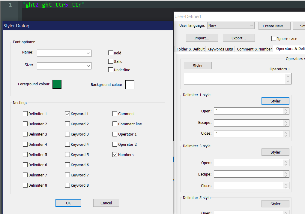

 All right… It might as well be some kind of delimiters problem. You need to add these group of keywords and the numbers inside any delimiter and then it turns out to look like this:
  Same if I clear all unnumbered keywords:
 The UDL definition is not infinitely powerful, nor even a full programming langauge; if you keep looking, you will eventually found its limits – and you appear to have found one. I assume it’s not really inside quotes, but inside a function’s argument-list parentheses, where you want numbers formatted as numbers, and keywords as keywords. Either you need to just not mark the parentheses as delimiters (since you don’t seem to want stuff in the parentheses to be treated differently than the stuff outside), or you need an alternate way of highlighting instead of relying on the UDL syntax. So, if you need parentheses as delimiters, I suggest to use the PythonScript plugin, which can be used to add/change formatting from a builtin or UDL lexer using regexes, via the script EnhanceAnyLexer.pythat @Ekopalypse shares in his github repo : install the PythonScript plugin, create the script and populate it, then change the regexes to something that matches the “mix-formatted” keywords-with-numbers, and

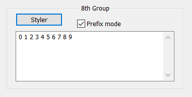

 In the end I just set up all numbers as keywords with prefix and turn nums off from all delimiters entirely :|
  Guess it’s just works for me from now on. The stupid number priority is gone and I’m even still able to use HEX constants like 0x80LOL123. Will update this topic if I find any problems with such solution.

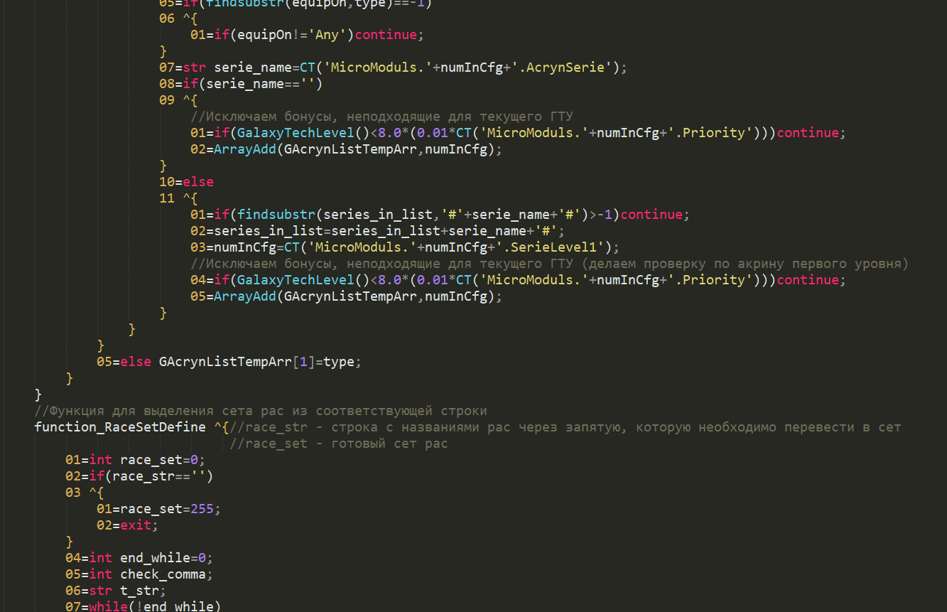

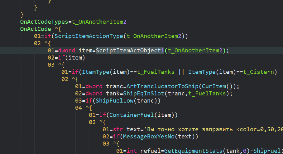

 @Ekopalypse said in UDL numbers problem: but also words like ScriptItemActObjectAndWhatEverIsAttached Sure do. But while I’m using prefix only on number simbols, I most likely, never will fall into 0.1AndWhatEverIsAttached problem, because there’s always some operators on the way ahead this numbers. And since my prefix “numeric” keywords has a lower priority than normal keywords, such a ScriptItemActObject1, it’s highlights only after them which is totally fine for my needs by now. Here’s an example of how it looks:
  Too bad, UDL functions are some buggy ad sometimes makes some errors in highlighting system:
  Yet, this is not depends on my “numbers-keywords”, just some regular errors in UDL code.

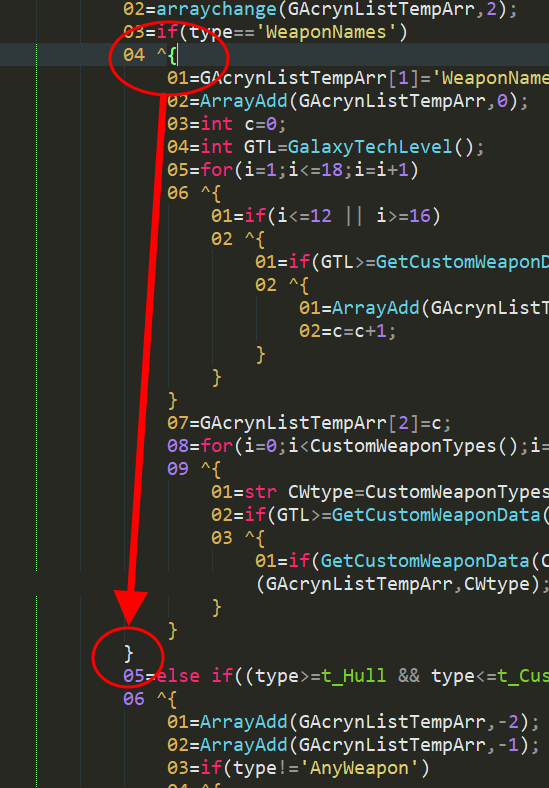

 @Ekopalypse said in UDL numbers problem: Yes - I have also seen other problems like strange folding markers. The most strange about folding markers in UDL is that I can’t use them with stylers. There’s just no options to highlight any groups of keywords or other anything else inside the folding markers. Instead I may create “folding” markers as a delimiter, but then it just refuse to folding anymore :/
 And I can’t just adjust delimiter and folding markers with the same symbols, because delimiters have absolute priority over folding markers.

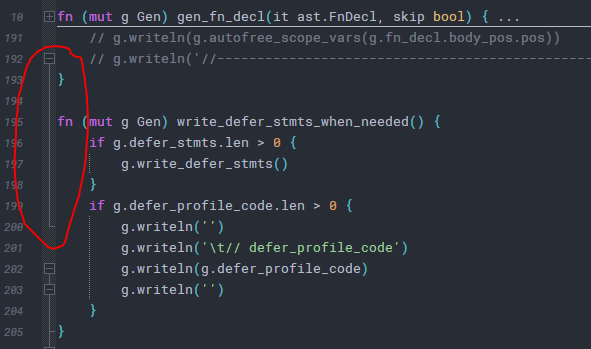

 No, what I meant refers to such an issue  where the folding marker is out of sync with the code block.
