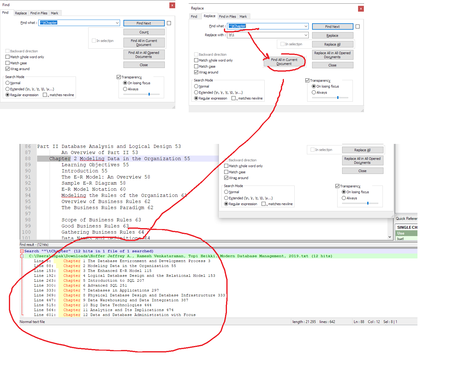

        What version of Notepad++ has a Find All in Current Document on the Replace tab ??

          I think the that the picture is a mock up.

            @Ekopalypse said in Can I see a preview for the result of the "replace" form?:
            Then, a confusing mock up! :-)

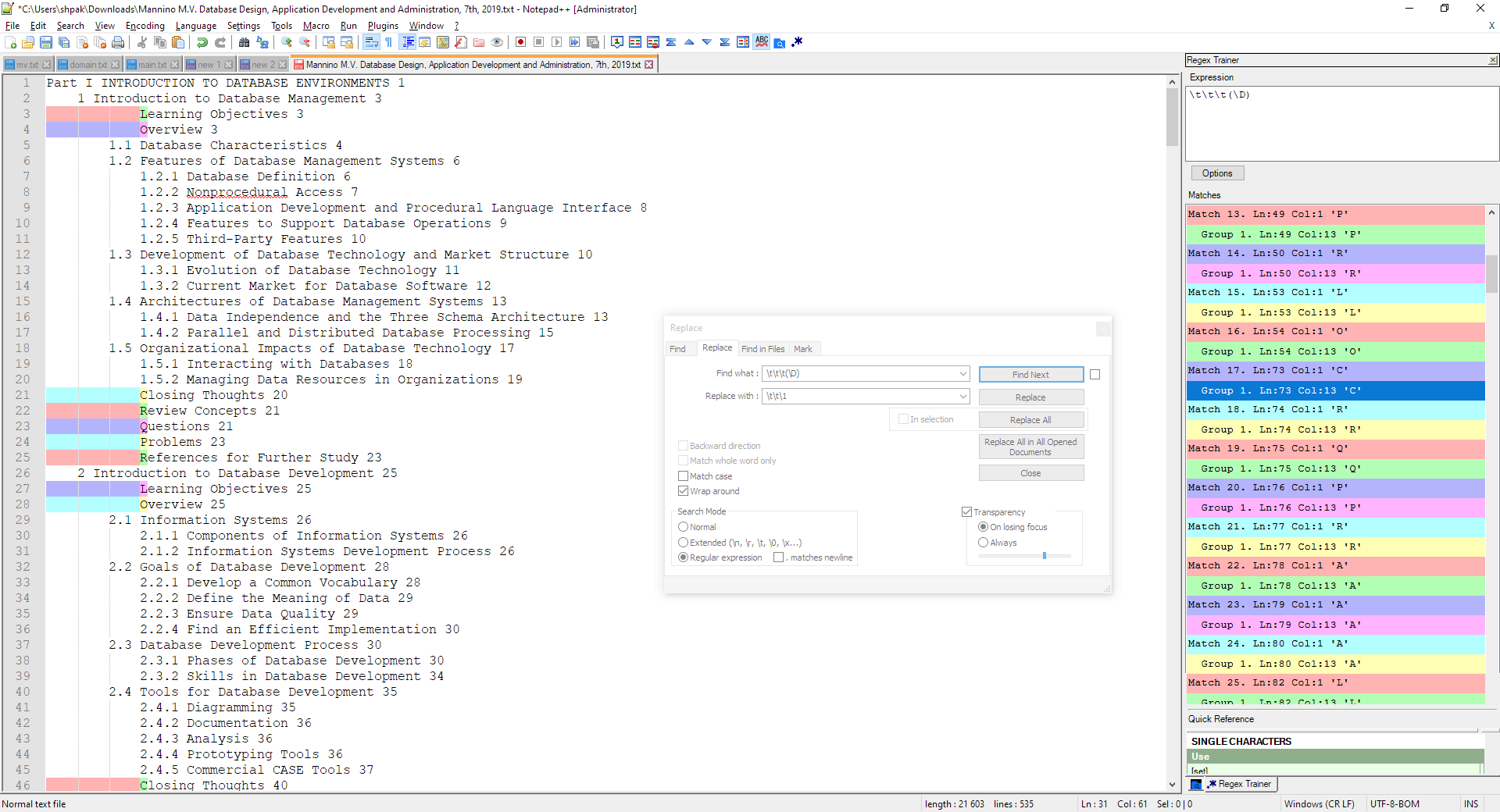

                @Aliaksandr3by
                This may work for your original query:
                • get the Compare plugin
                • when you want to do this type of preview, first save your file
                • do your replacement operation (Replace All is probably most effective for this “demo”)
                • run Plugins > Compare > Diff since last Save
                This will give you a “preview” of your replacement action.
                If you don’t like what was replaced, simply Undo the replacement.
                  Here’s an example of what such a “preview” could look like:
                  Imgur
                    It looks like this POSTING is where I “stole” this idea from. Cred where cred is due.
