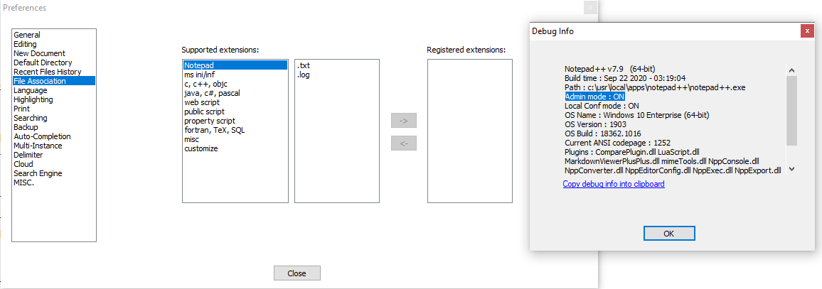

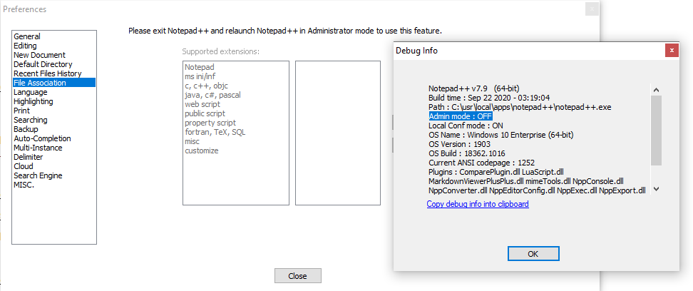

        Are you sure it actually ran as admin when you chose Run As Administrator? Does the title bar say [Administrator] at the end? Does the ? menu, Debug Info say Admin mode : ON? If not, then you didn’t actually run as administrator.
        If it does say that you are admin, can you give us a screenshot of your Preferences > File Association, because in Admin mode, mine looks right:
        When I am normal permissions, my File Association settings show:
        My screenshots added Debug Info on top, to make it clear whether I was in Admin mode or not.
        Or, are you saying that with Admin, you look like the first screen, but it still doesn’t change anything?
