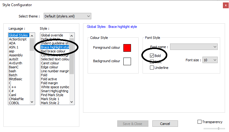

        Did you look at the Style Configurator?
        Menu Settings => Style Configurator:

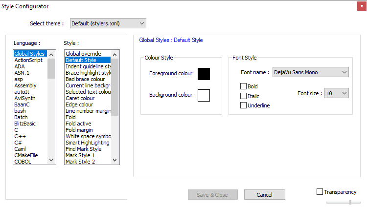

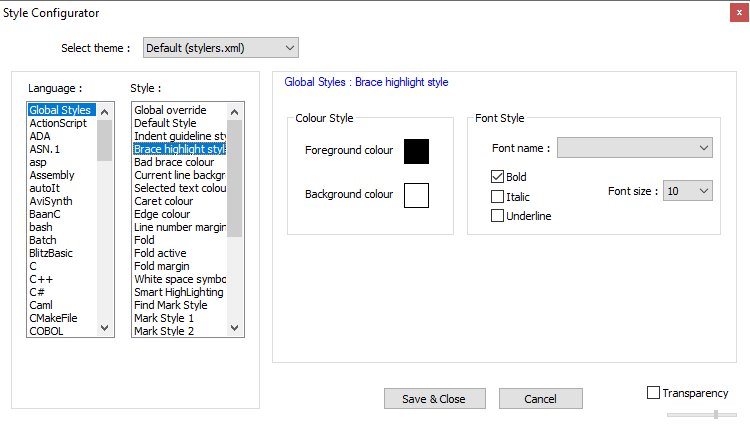

            So, in addition to showing the Debug Info as @ArkadiuszMichalski asked for, you might also want to look at Settings > Style Configurator on both the Style: Default Style and Style: Brace highlighting style, and see what font/size/bold settings are enabled. (Alt+PrintScreen and paste in here, if you want us to help you evaluate that).

                        @litos81 said in Parentheses/brackets/braces turn bold on current line? Intentional?:
                        Perhaps you might check both your Font name and Font size are left blank in your Brace highlighting style (I think blank values match whichever style you have in your Default style) or at least having the same font or size as the default style…
                        Thanks for the idea. I checked, but I have no specific font associated with that:
                        alt text
