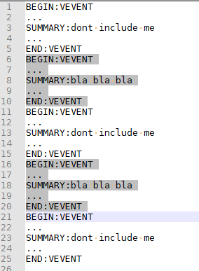

              Hello, @marcin-jewiarz, @Terry-r, @peterjones and All,
              We may solve the problem in a more simple way, with these two other solutions :
              • First solution :
                • Use the Mark regex (?xs-i) BEGIN:VEVENT ((?!BEGIN:).)*? \Qbla bla bla\E .*? END:VEVENT\R?
                • Then, run the menu option Search > Bookmark > Remove Unmarked Lines
              • Second solution :
                • Use the regex S/R, below, with a negative look-ahead :
                  • SEARCH (?xs-i) BEGIN:VEVENT \R ((?!BEGIN:|SUMMARY:\Qbla bla bla\E).)+? END:VEVENT \R?
                  • REPLACE Leave EMPTY
              See an updated version of these regexes at the end of this post :
              https://community.notepad-plus-plus.org/post/58092
                        Remark : In the first solution, we still need to the regex ((?!BEGIN:).)*? instead of the .+? one, to restrict the match to a single block. Indeed, the simple regex .*? can match a line END:VEVENT and the line BEGIN:VEVENT of the next block !
                        P.S. :
                        I’ve verified that my updated second solution does match, as expected, a BEGIN:VEVENT....END:VEVENT block, which does not contain any line SUMMARY:........ like :
                        BEGIN:VEVENT
                        END:VEVENT
                          Terry R
                          @guy038 said in .ics file selection problem:
                          at beginning of my post are totally independent !
                          Firstly my apologies. I got fixated on the concept of using a positive lookahead after looking at both of your solutions. For some reason later on a did mix them together and thinking there were 2 steps.
                          Perhaps in my defence I’ve just come to realise my reasoning all the way through was that there would be extraneous lines between the END:VEVENT and BEGIN:VEVENT lines, that is, between the record sets. I’ve just googled a typical ics file and whilst that isn’t true there are additional lines before AND after (header and footer info) the sets we were identifying with the regexes. I’ve got a longish one and reduced the size so you can see what shows in the file.

                          So although the OP never showed this I had made the assumption I couldn’t guarantee there weren’t other lines, nor did I think to ask.
                          Thanks for critiquing my regexes. I had made a discovery and couldn’t quite believe I hadn’t considered it before. There have been lots of instances where I wanted to find a data set with a specific string using the lookahead and seeing it would continue through other sets UNTIL it found the correct one. The realisation I had the power to stop it upon a failed string search within the 1 data set was (dare I say it) overwhelming. It was like a light had suddenly switched on, learning a new ability with regexes.
                          Cheers
