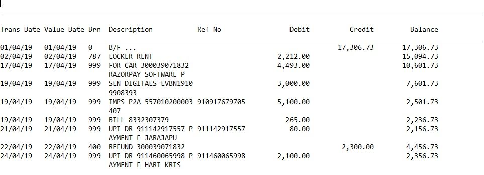

              I am attaching the sample text. Please check if this helps else I will upload the full text file. The Description column is sometimes split into two,three,four lines
              The extension of the original file is .htm I copied the data from htm to notepad++ and saved in .txt format

                PeterJones @Suresh Reddy
                @Suresh-Reddy ,
                Given that text file, it can easily be imported into Excel or another spreadsheet, because one of the options in the text-import is to manually define column widths in terms of number of characters, and you’ve definitely got a fixed-width format there.
                Trying to parse a mangled report using regex, instead of using the original data, is really the wrong way to go about things. The right way is to ask for access to the original data in a machine-readable format, and go from there. Or if your goal is just to get a new copy of the report with “better” formatting, then ask for the report to be modified.

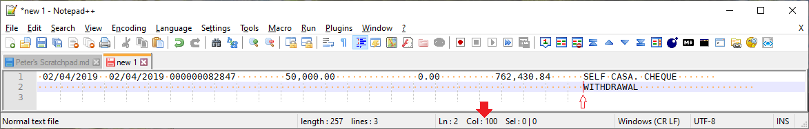

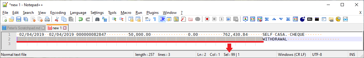

                                  @Suresh-Reddy ,
                                  I could have counted the spaces – easier to do with View > Show Symbol > Show Whitespace and TAB
                                  Or, with my cursor at “WITHDRAWL” from your example data, Notepad++ says the cursor is at column 100, which means that there are 99 spaces before:
                                  Or I could select all the spaces, and the status bar tells me the selection is 99 characters wide:
                                  Any of those will work
