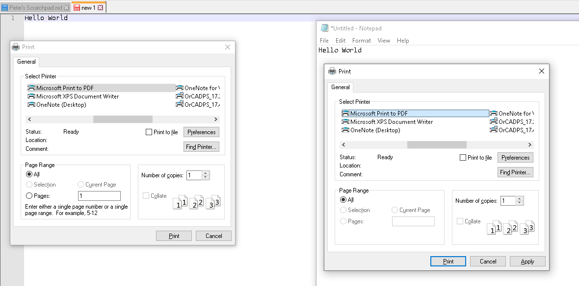

          Further to what I said earlier: I just confirmed that Notepad++ and Windows Notepad both use the same dialog, both presenting the same printer options.
          If I pick the same printer on either and hit Print, it will work the same.

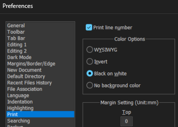

          Notepad++'s Settings > Preferences > Print has some options that will influence how the text is seen. The Preferences > Print section of the official Notepad++ User Manual describes those options. There is the possibility that you have a light (or white) foreground and dark background, with print options saying “no background colour”, which would then print light (or white) on paper (white), which would be invisible. So if you really are having problems based on colour, trying “Black on White” should give you the best indication of that.

              There a lot of things that might affect printing, including the style/theme you use. To offset any potential issue with colour, try enabling black on white for Settings, Preferences, Print.

                  I think I see what happened. NP++ is interpreting the theme a bit too literally… even during print. Have not reviewed, maybe there are settings that workaround this “feature”, not sure…
                  Okay, so instead of “Colour Options”, “No background colour”, which was how it was selected. Changed to “Black on white” and that solved the issue for me.

                      This makes sense. In a quick experiment, my “dark mode” has printed as hard-to-read contents but nice-looking line numbers:
                      I’m using Dark Mode and had the default print setting, No background color.
                      Therefore it may be a matter of defaults: if more people are starting to use Dark Mode more unexpected results will be obtained. A quick suggestion would be taking @Michael-Powell hint and changing the default to Black on white:
