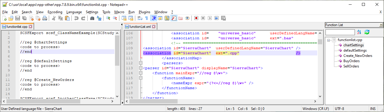

          PeterJones @JR
          @JR said in FunctionList help:
          i have copied your code and cannot get it to return the functions. I can go to an online Regex playground and return the Class and functions, but when i try and translate it into the FunctionList.xml it fails
          For the FUNCTION only version:
          I have grabbed a fresh copy of NPP.v7.8.9-64 and unzipped to a known location, and started from there.
          I defined a UDL called “SierraChart” with extension .cpp:
          When I add the <association entries and <parser entry in the appropriate locations, it works for me as I would expect for functions only:
          Please note that in the code you posted for the FUNCTION-only version, you did not have the <parser ...> entry inside of the <parsers> tag: I don’t know if that was real, or a result of your pruning for the forum. My excerpt can be seen in the screenshot, and here is a direct copy paste, where there is stuff before and after, but everything shown is exactly contiguous:
          <association id="SierraChart"  userDefinedLangName="SierraChart" />
          <association id="SierraChart"  ext=".cpp"                        />
          		</associationMap>
          		<parsers>
          <parser id="SierraChart" displayName="SierraChart">
          	<function mainExpr="//reg @\w+">
          		<functionName>
          			<nameExpr expr="(?<=//reg @)\w+" />
          		</functionName>
          	</function>
          </parser>
          Please remember that after you make changes to functionList.xml, you have to exit Notepad++ and reload for it to take effect.
          I will try to experiment with the classes next.
            PeterJones @JR
            @JR ,
            At first glance, in your CLASS-enabled, I found two bugs
            1. It’s also not showing the <parsers>... open tag. Again, that might just be your editing
            2. The <association...> lines both use SierraCharts (with an s at the end), whereas your first example, and your claim about your UDL, use just SierraChart (with no s). It will not work unless the userDefinedLang name exactly matches the UDL name, and the <parser id exactly matches the <association id.
            I will continue to explore, correcting those two bugs.

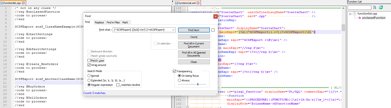

                • JRJ
                  JR @PeterJones
                  @PeterJones thanks for taking the time…
                  here is a pic of just the classes. using the BoostRegex playground software it captures both areas of classes, then specifically the class names.
                  i also cant get it to work (i fixed the userLang issue, also i kept only the classes to test, removed any function expr.)
                  https://i.imgur.com/P5nBqYP.png
