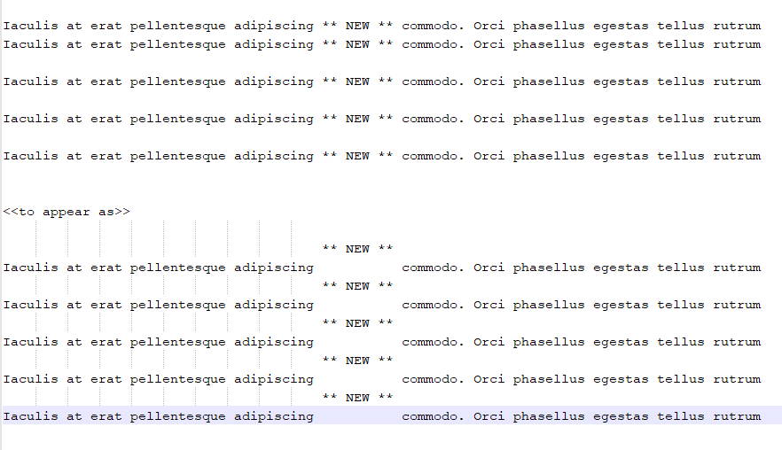

      I am needing to perform a search on a large txt file for "** NEW ** and if found place it in the row above. I also don’t want to add or remove spaces on the lines. Not sure how to describe it but if I remove the found 9 characters ** NEW ** I would like to replace those with spaces. Similarly, when the data is moved up one row, I would then need to trim off 9 spaces.

            George Corder @Alan Kilborn
            Sorry, the code didn’t appear as I expected so I uploaded a screenshot.
              Alan Kilborn @George Corder
              @George-Corder
              A screenshot is not as desirable for those that might want to play with your data in order to offer a solution. No one wants to type something in in order to experiment.
              Not sure what might have gone wrong for you in entering the data, but a lot of people seem to have trouble providing data.
              Regarding your problem, it’s tough to say as your sample is all the same data.
              I would have been great if instead of providing 5 identical lines, you provided 5 different lines…
              Well, you’re adding spaces before the ** NEW ** on the line, are there spaces after it?
              I don’t know…it still seems inconclusive to me…as a problem statement…
                Hello @george-corder, @alan-kilborn and All,
                Given your text, below :
                Iaculis at erat pellentesque adipiscing ** NEW ** commodo. Orci phasellus egestas tellus rutrum
                it seems that the ** NEW ** string always comes after 40 space characters
                So using the regex S/R, below :
                SEARCH  =(?-i)(^\R)?^(.+)\Q** NEW **
                REPLACE =                                        ** NEW **\r\n\2
                This text would be changed as :
                                                        ** NEW **
                Iaculis at erat pellentesque adipiscing           commodo. Orci phasellus egestas tellus rutrum
                                                        ** NEW **
                                                        ** NEW **
                                                        ** NEW **
                                                        ** NEW **
