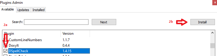

- Notepad++ > Plugins > Plugins Admin
 - Click the checkbox on DSpellCheck (2a) then click Install button (2b)
 - It will prompt that it will restart notepad++, which is what you want.
 - Wait patiently for the progress bar to hit 100%
- If I tried to do something else, it would cancel the dialog without my noticing.
 - If you let it finish, it should start Notepad++
 - If something went wrong, re-start Notepad++ and try again.

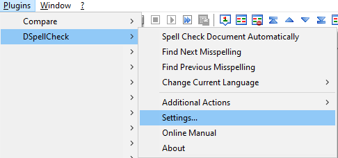

 - Plugins menu should now have the DSpellCheck sub-menu

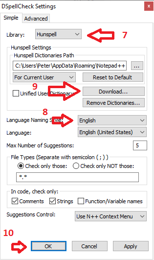

 - Go to Plugins > DSpellCheck > Settings
 - Leave the dictionary at Hunspell. Switching to Aspell requires additional libraries and installation, and isn’t necessary to get spell check working!
 - Pick your Language (my screenshot shows English)
 - Download the English Dictionary
 - Apply and OK (probably just need OK, but I hit Apply just in case)

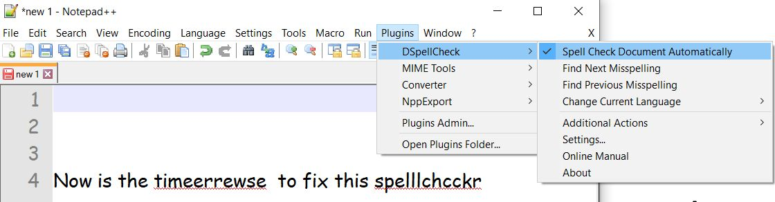

 - If the Plugins > DSpellCheck > Spell Check Document Automatically is enabled, it should automatically squiggly “misspelt” words.  Otherwise, you might have to ask it to find next or previous.

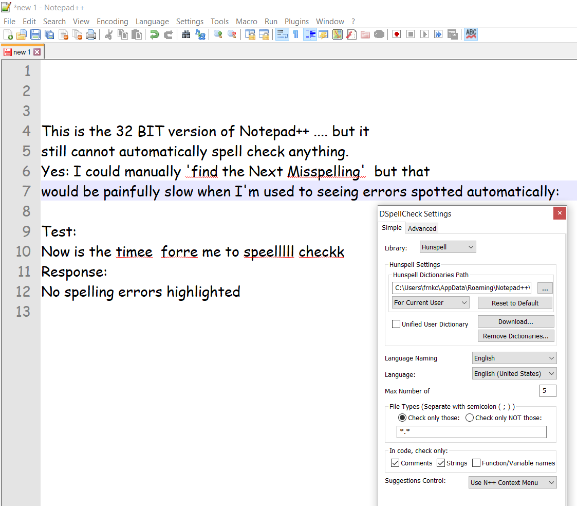

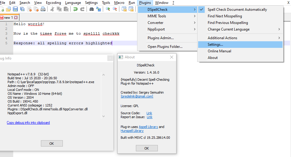

Thanks for getting me closer! I was able to manually find one spelling error at a time, but first using the 64 Bit version of Notepad, and then when that failed, installing and configuring the 32 bit version of Notepad, I didn’t get far…64 BIT EFFORT
32 BIT EFFORT
Any additional ideas?
Thanks again -
v7.8.9 32bit with DSpellCheck 1.4.16.0 automatically spell checks for me, when I follow the same sequence as I showed for v7.8.9 64bit.
Further, in your picture, I see the misspellings highlighted. So I’m not sure what your problem with the results is.
Spelling cannot contain all words that exist in the world, some words can be manually added to ignore or to a custom spelling dictionary.
THANK YOU!
whether it was my computer monitor or font size or shrunken size window in Notepad++ I simply could not see the underscored red dots showing the spelling errrors. They showed up CLEARLY in the copy/pasted JPGs in my response… I just didn’t see them on my computer.Oh my… Does this mean I’ve passed middle age? Sorry …
