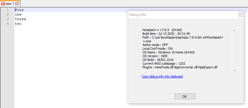

                                I just downloaded a fresh npp.7.8.9.bin.x64.zip, unzipped to a writeable location on my drive, and ran from there. I typed the four lines
                                one
                                two
                                three
                                four
                                Then ran Edit > Line Operations > Sort Lines Lexicographically Ascending, and the file now contains:
                                four
                                one
                                three
                                two
                                It sorts exactly as I would expect it to. Here is a screenshot:
