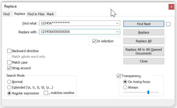

      Hello.
      I am trying to find any field that is 16 digits long that starts with 123456 and replace it with 123456XXXXXXXXXX.
      Here is a snapshot of what I am trying to accomplish.
      I tried 123456.*, but it replaced everything to the right of that field. I just need that specific field updated.
      Any assistance you could provide would be appreciated. Thanks.
        PeterJones @Andrew 0
        @Andrew-0 ,
        Very close. The * quantifier means “0 or more”. What you want is a quantifier that gives an exact number of digits… in this case, 123456.{10}, which says “123456 followed by exactly 10 other characters”.
        You might change it to 123456\d{10}, which says “123456 followed by exactly 10 numerical digits”.

          Holy Snikies!
          Thank you so much. I have been searching high and low for that solution. Appreciate it!
