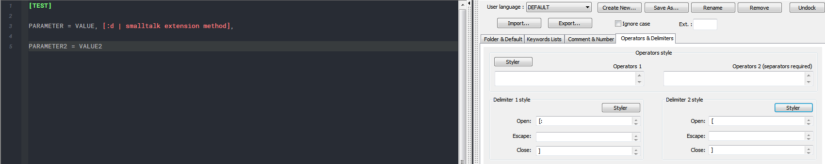

      I am trying to remove a bold formatting that comes from an UDL using PythonScript and the EnhancedUDLLexer example which is modified.
      Here is a concrete example
      [TEST]
       ^ this is bold and should be bold
      PARAMETER = VALUE,[:d | smalltalk extension method],
                         ^ this should not be bold, yet it currently is
      PARAMETER2 = VALUE2
      I already got a fitting regular expression ready, albeit being a little hacky:
      \S{1,}.*(\[((?>[^\[\]]+|(?R))*)\])
      However I am not able to modify the display of the found texts decoration. Changing the color works well, but isn’t what I want.
      Is there anything I can do about this. If not by PythonScript, then eventually with UDL file modification.
      Bonus points, if it is somehow possible to change syntax highlighting to the pre-installed “Smalltalk” but only inside the aforementioned statement. ;)
      Thanks in advance!
      Daniel

        Indicators do not have access to all font attributes, well, the only
        access they have is the font foreground color.
        I assume you’ve configured the [ and ] being delimiters with a bold style, correct?
        Is it possible to define two like in this example?
