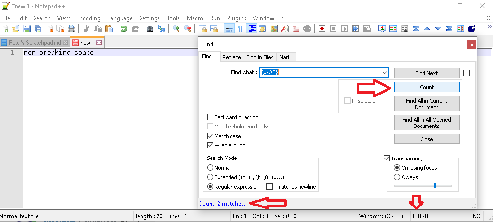

                    @Bart-Heinsius ,
                    To help us understand what’s going on for you, could you share a screenshot similar to the following:
                    I created a file with non-breaking spaces between the words (so there were two of them), and did a Count, which correctly showed the two. My screenshot also includes the current encoding in the status bar:
