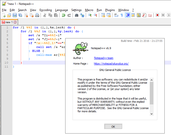

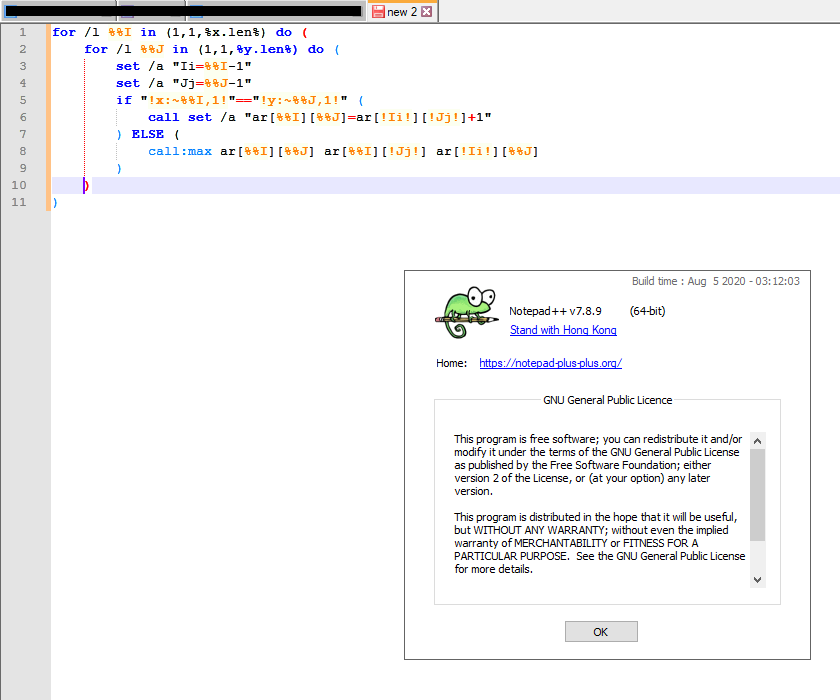

            Michael Vincent @Nyaruko Hayore
            @Nyaruko-Hayore said in what is last version of np++ where matching parenthesis was working?:
            code example (batch from dostips.com stuff)
            I believe this is a Scintilla parsing issue in the Windows Batch lexer. I don’t remember this ever working correctly in Notepad++. Are you sure Windows Batch specifically worked as you expected in the 6.9.2 version? I don’t have that version, but I can get 6.9 from the website and it exhibits the same behavior as 7.8.9 for me:
            6.9:
            7.8.9
            Note the brace highlighting works in both versions if you select Normal Text as the parser instead of Windows Batch.

                Michael Vincent @Alan Kilborn
                @Alan-Kilborn said in what is last version of np++ where matching parenthesis was working?:
                put the cursor on one of last three ‘)’ and see where the highlighting ends up
                Still didn’t see a problem.
                The last line won’t exhibit the behavior, but the second to last as in my screenshots will. See the opening parenthesis highlighted is wrong - I should have the opening parenthesis on line 2 highlighted, not line 1.
                But again, this has never worked for Windows Batch for me.
                See here for Scintilla bug: https://sourceforge.net/p/scintilla/bugs/1624/
                and here for Scintilla fix: https://sourceforge.net/p/scintilla/code/ci/bc6bc207a6d4a5ce787b9cb3320c8e1a0b22adb2/
                Note the fix was April of 2020 so we don’t have that version of Scintilla integrated to Notepad++ yet.
