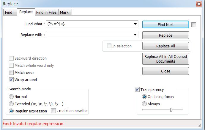

      step by step: does not work
      a cd eg g h ik
      (?<=\s)(.)
      \u$0
      a cd eg g h ik
      Where is the mistake?

            I don’t think that is a bug. I believe it’s the issue I mentioned. Your look behind is NOT a fixed width. The ^ is a zero width “character”, start of line. The “e” is 1 character wide. That probably makes the regex invalid.
