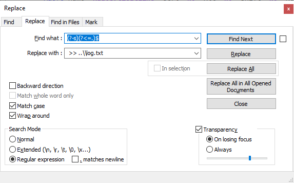

                That said, the Notepad++ search-and-replace functions can be recorded in macros. With regex-based search-and-replace, and the Replace All function, you can easily accomplish your goal:
                • Macro > Start Recording
                • Search > Replace
                  • FIND = (?-s)(?<=.)$ – make sure dot doesn’t match newline; make sure there’s at least one character in the line (I assumed you didn’t want to add the text to an empty line); match the end of the line
                  • REPLACE = >> ..\\log.txt (there is a space on each side of the >>
                  • REPLACE ALL
                • Macro > Stop Recording
                • Macro > Save Current Recorded Macro
                After exiting Notepad++, shortcuts.xml should contain a macro similar to:
                        <Macro name="ForumPost19765" Ctrl="no" Alt="no" Shift="no" Key="0">
                            <Action type="3" message="1601" wParam="0" lParam="0" sParam="(?-s)(?&lt;=.)$" />
                            <Action type="3" message="1602" wParam="0" lParam="0" sParam=" &gt;&gt; ..\\log.txt" />
                            <Action type="3" message="1702" wParam="0" lParam="770" sParam="" />
                        </Macro>
                There is a whole section of details on search-and-replace macros in the official docs here: https://npp-user-manual.org/docs/searching/#searching-actions-when-recorded-as-macros – that will explain the 1700, 1601, 1625, 1602, 1702, 1701 sequence (including that the message=“1701” with lParam=“1609” means “Replace All”).

                  Dear Peter,
                  this was the information I needed; now the macro works fine.
                  Lots of thanks to all who (tried) to help me.
