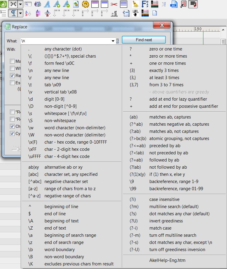

              I don’t have a \R
              I have to deal with \n
                Terry R
                Indeed your image above suggests that \R is not available to you. As @guy038 mentioned in one of your first posts in this forum
                https://community.notepad-plus-plus.org/topic/19649/i-would-like-to-find-lines-where-there-are-2x-double-spaces/11?_=1595705980547
                Your editor may well not have it. I can see from your image it is AkelPad which you had mentioned. Be aware that if you ask for help in this Notepad++ forum you will get answers specific to Notepad++. Don’t expect people here to help you with a different editor!

                  @Pan-Jan said in RegEx... Exchange:
                  I don’t have a \R
                  Try \v for vertical whitespace. Perhaps it works in that editor.
