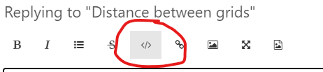

                        Also, it would be really nice if you followed my original advice and used the forum’s toolbar or manual Markdown code to format your example text as text, so we could be sure that we were seeing what you were originally typing (the forum considers many characters and character-combos as special, and will make changes. For example, I am betting that you typed 'GG43' with normal ASCII single quotes, but the forum sees quotes as something it can modify, so it presented it with so-called smart-quotes / curly-quotes, as ‘GG43’. If the quoting had ended up being important to your question (which it didn’t, in this instance), it could have sent us down the wrong path.
                        It also makes the data stand out as data; see my modified-quote of your text.

                              Please use the toolbar button </> to format your text:
