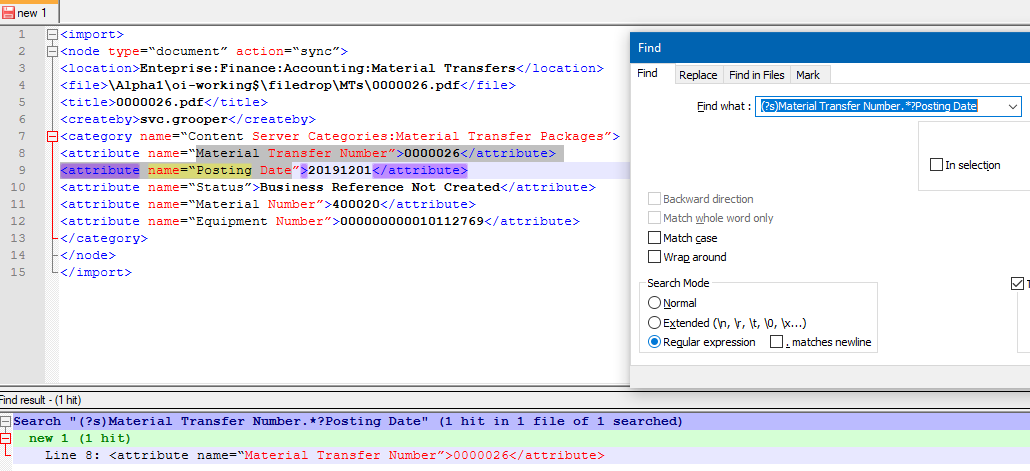

                  Alan Kilborn @Scott Wallace
                  @Scott-Wallace said in Find in Files two phrases:
                  But the above showed zero results.
                  Hmm, not sure.
                  Here’s the result of my try at it:
                  Double-clicking the Line 8 result in the Find result window jumps the input focus into the main window to select all text beginning with Material and ending with Date.

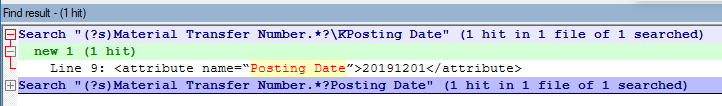

                  …results section to display the Posting Date line
                  Ah, well for that you’d need to do it a bit differently as in my screenshot above Posting Date is not visible directly in the results, only when you double-click on a specific line in the results.
                  The reason for this is that in the results, only the first line of a multiline result is shown.
                  For that I would try this variation (?s)Material Transfer Number.*?\KPosting Date to obtain this where it IS visible in the results:
                  The \K makes the posting date be the line that is shown in the results.

                  • Scott WallaceS
                    Scott Wallace
                    @Alan-Kilborn said in Find in Files two phrases:
                    Alan, the issues were typos on my side. The (?s)Material Transfer Number.*?\KPosting Date gave me exactly what I needed.
                    Thank you so much for all your help.
